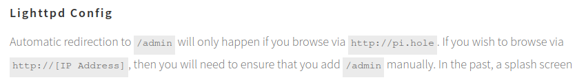

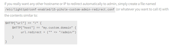

Set up a redirect as described in the release notes that made that change:
Judging by what it's saying, it sounds like http://pi.hole should be redirecting without the need for any intervention, but it doesn't.
I could in theory even use http://pi.hole to achieve what I need, but first I need it to work.

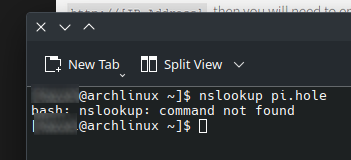

From the terminal or command prompt on the client that you are using to access the web admin GUI using http://pi.hole, what is the output of the following command:
nslookup pi.hole
Was that run on a client?

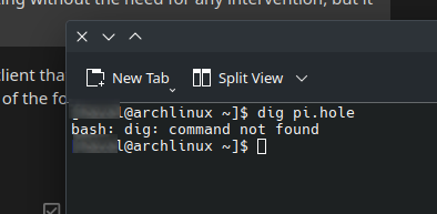

If it was, try dig instead:
dig pi.hole

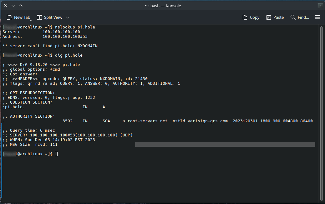

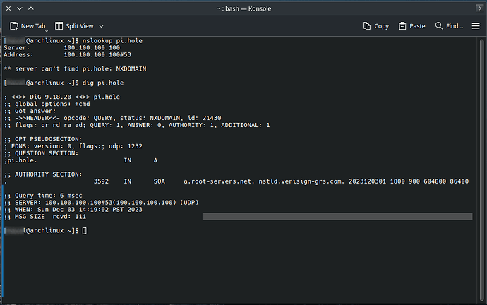

From his words, I understood that he wants me to run that command on the device I am using to access the web interface, which is my desktop. I ran that in konsole using Arch Linux.
Same result with dig
Thats correct.
Just making sure.
You can install nslookup and dig for Arch Linux with below (about 6MB by the looks):
What DNS server is at IP 100.100.100.100?
Tailscale magicDNS
The client isn't using Pi-hole for DNS, so it is unable to get resolution for the name pi.hole to the Pi-hole IP.

The link has instructions for a configuration change that will do the redirect from the IP address. Does that not work for you?
If you really want any other hostname or IP to redirect automatically to admin, simply create a file named /etc/lighttpd/conf-enabled/15-pihole-custom-admin-redirect.conf (or whatever you want to call it) with the contents similar to:
$HTTP["url"] == "/" {
    $HTTP["host"] == "my.custom.domain" {
         url.redirect = ("" => "/admin/")
