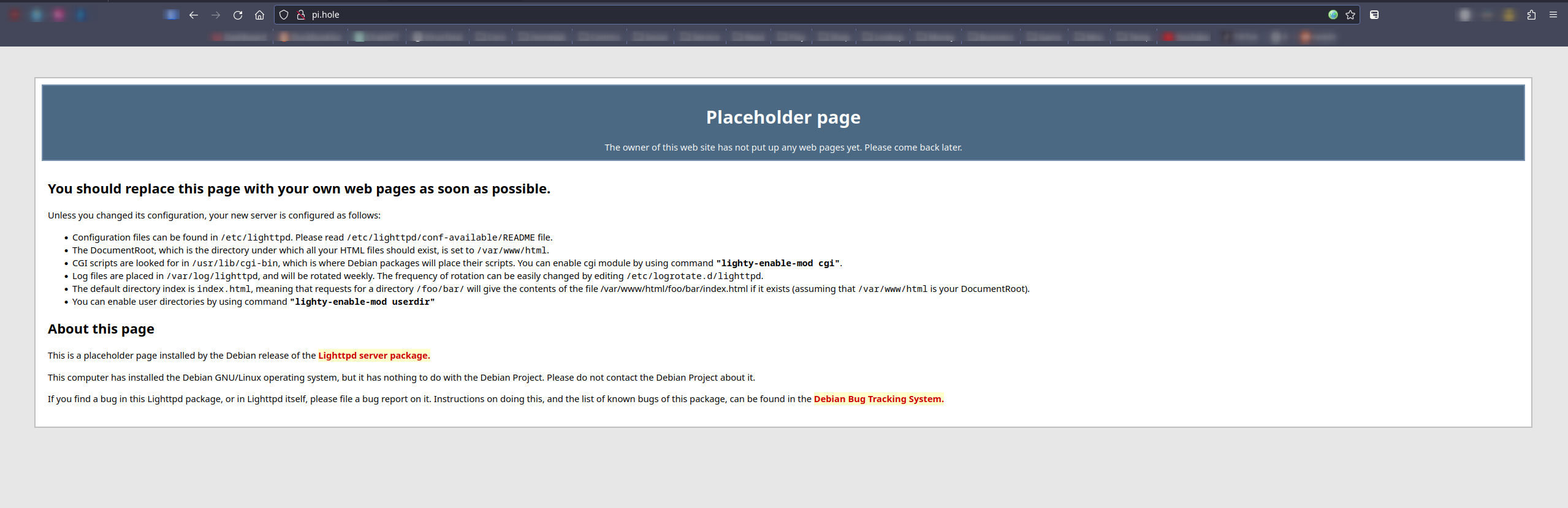

Okay now http://pi.hole responds, but it takes me to this page. Also, I have two pi holes running at the same time. One for backup, so how would I make this feature of using that default hostname work when running two piholes on the same network?

Did you see my post prior to this one? I got http://pi.hole to finally respond but not to the actual web interface.

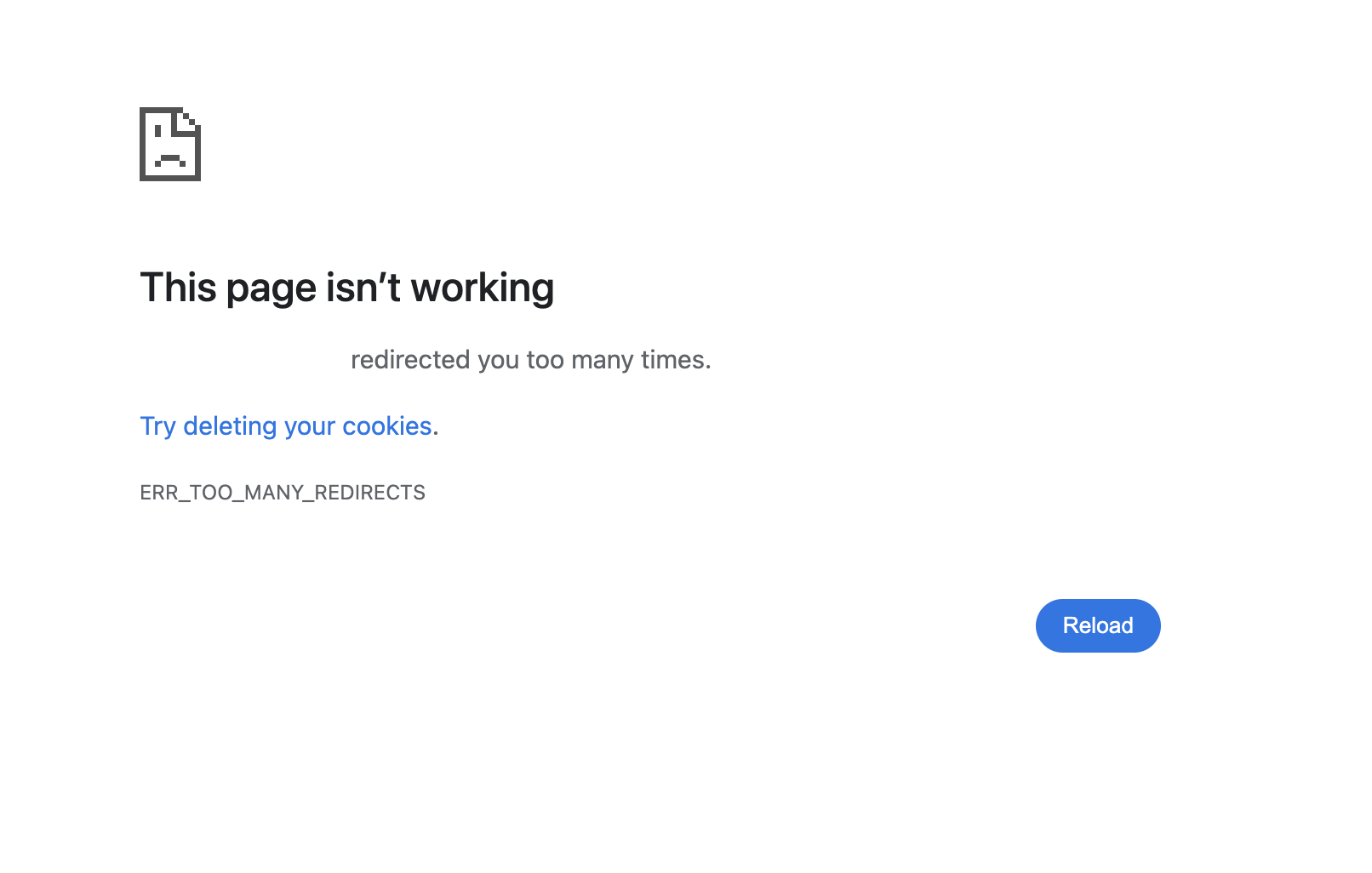

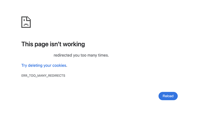

Don't work
  • i have added in pihole web custom domain
    pi.hole > x.x.x.x
  • followed Step #2.
    now i can access to web of pi-hole > pi.hole
  • followed Step #3.
    but not working
