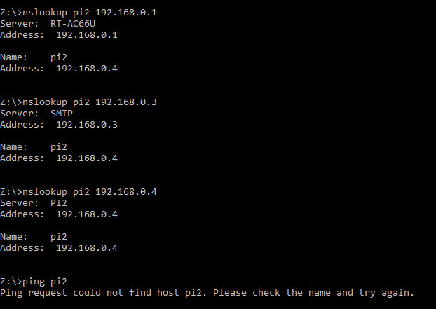

Ok so any ideas why DNS resolution isnt working for things in the DNS Records in PiHole?
Did you verify whether DNS is involved?
Use dig or nslookup to analyse DNS issues.
I guess its not DNS but doesn't make sense. The changes I made using 42-unqualified-hosts-forward.conf should send the non FQDN to my router which does know what pi2 is...
Your nslookup results demonstrate that your Pi-hole (at .3) correctly handles DNS requests (what's .4, by the way?).
I agree that your Windows ping behaves strange (though that misbehaviour isn't that uncommon either), but there's nothing that Pi-hole can do about that - if that tool doesn't send a DNS request, Pi-hole cannot provide an answer.
Did you try the alternatives I mentioned, e.g. does ping pi2. work for you?
.3 and .4 are my PiHole's.
Yes I agree but I have same problem with other apps like putty for example, see above screenshot. So this is very strange.
Yes, strangely, however ping pc and ping of other machines works without the dot, why is that?
That would be a question for the developers of ping and the respective other tools, and ultimately for the name resolution service of your Windows OS.
As long as you are able to provide the dotted name, you should be able to force DNS resolution via Pi-hole for your tools.
Although it only seems to be affecting my PiHole's, everything else works fine without the dot

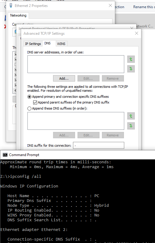

Did you try to configure the single dot as local search domain on that client's network adapter yet?
Do you mean my PiHoles? I don't think so they are using Ubuntu 20+. One is a PI2 and other is VMware VM.
Do you mean like this? It didn't make any difference....
