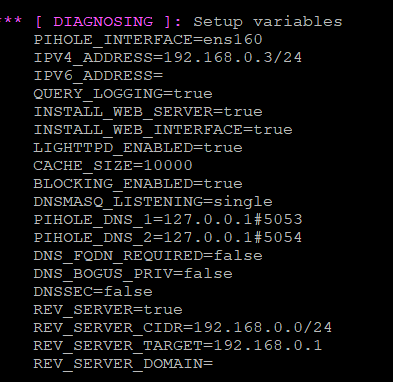

https://tricorder.pi-hole.net/z7s4As8I/
You may see from the log, I've blocked access to Google DNS on my Router as I use DNS over HTTPS but this isn't anything to do with this issue.
That isn't right, has something gone wrong and you are looking at someone else's debug token?
Yes I am. Apologies. Many help tickets open at once. Let me start again with a proper reply for your issue.

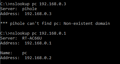

I did as screenshot above, here is it is a text...
C:>nslookup pc 192.168.0.3
Server: pihole
Address: 192.168.0.3
*** pihole can't find pc: Non-existent domain
C:>nslookup pc 192.168.0.1
Server: RT-AC66U
Address: 192.168.0.1
Address: 192.168.0.2
No worries, i should get sleep now too! thanks

I guess the reason the forward lookup doesn't succeed is likely this:
Reverse lookups are taken care of by
rev-server=192.168.0.0/24,192.168.0.1
But since you have no local domain, a line like the following is missing:
server=/fritz.box/192.168.0.1
Normal DNS lookups will therefore be handled the usual way:
nslookup pc will have Pi-hole check if it knows A or AAAA records for pc itself, and since it doesn't, those queries will then be forwarded upstream - without a local domain, Conditional Forwarding can't kick in.
To fix your issue, you can either define a local domain on your router, have Pi-hole act as your DHCP server, or define local DNS records for your devices.
In case your router is distributing Pi-hole's IP address as DNS server via DHCP, you could also configure Pi-hole to use your router as its sole upstream and ditch CF altogether.
This would probably be the easiest approach.
However, that option is only viable if your router would not be using Pi-hole as its upstream DNS server (lest you would close a DNS loop).

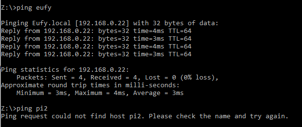

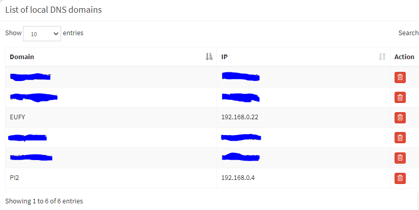

Thanks, looking better but getting some strange results with the entries in the DNS Records in PiHole. I know you said don't use ping for DNS issues but its strange that it works with one entry but not another?
And considering that PI2 is my other PiHole and in my DNS its very strange it doesn't find it!
ping uses many different means to resolve hostnames, not just DNS.
The .local domain in your above first command result suggests a resolution via mDNS.
ping would also consider local hosts file entries e.g., and a Windows ping may also mix in things like lmhosts, NetBIOS resolution, WINS, AD services etc.. That's a lot of opportunities to have ping resolve a name that nslookup wouldn't know, or have it pick an address that has no corresponding DNS record match.
Under some conditions unknown to me, a Windows ping may also fail to issue DNS requests at all, and is then seemingly stuck with aforementioned different means for good.
Sometimes, ipconfig /flushdns is enough to prompt ping to query DNS again, other remedies include restarting Windows' DNS client service or the whole machine.
Alternatively, you should be able to force ping into requesting proper DNS resolution for a specific run by appending a dot to your name, e.g. eufy..
If this bothers you a lot because ping is constantly misbehaving by omitting DNS queries on your PC, then you could consider to manually add the dot (".") to your search domains for that PC's network adapater. This should prompt Windows tools to issue a DNS query (when they consider the search domain), but then it may also interfere with intended local hostname overrides on that machine.
And please, just don't ever give me a ping again if you want to analyse DNS issues. :wink:
EDIT: In other words, as said before: Please use dig or nslookup to analyse DNS issues.
