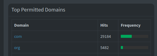

After installing a new client, which has DNSSEC enabled by default, a DNS loop happend: e.g. the client requested query[DNSKEY] com which is a non-FQDN and therefore it was sent to my rev-server instead of my local unbound instance. The router didn't know what to do and sent it back to Pi-hole creating a nice loop.
May workaround was to manually remove server=//IP from the dnsmasq config file.
I'm not sure how to fix this - maybe make an exception for DNSSEC not to be send to the rev-server? Make sure in such a configuration, the router des not use Pi-hole as upstream?
ADD
It's not only DNSKEY and DS but also SOA which looped massively.

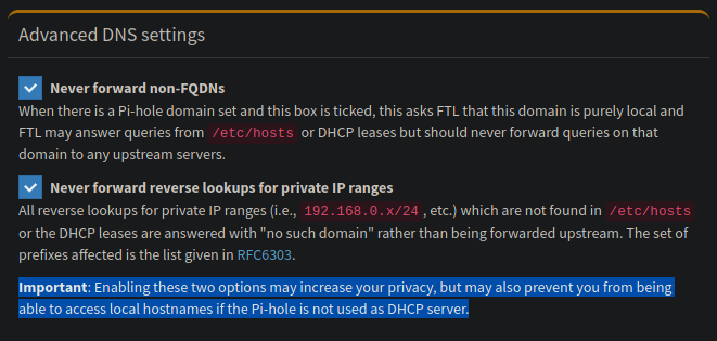

If so, please re-check it (the default) and see if this fixes the issue. I'm fine with undoing the recent change if this still doesn't fix it, however, I think it should and you should probably not have unticked the box in the first place when your router is conditional upstream and will send things back it is not authoritative for.
I'm not sure if it would be, as far as the client is concerned (or how to validate that).
I am not aware of any client OS that would enable DNSSEC by default.
I believe that Windows DNSSEC support would even be exclusive to the server OS line-up.
I do have it unticked now, but I guess it was enabled initially (did a bit of troubleshooting with the options).
I'm not sure if I can follow you here. You want me to enable CF and tick "Never forward non-FQDNs"? But what we really want is the opposite (or?): non-FQDN to be sent upstream, e.g. to get DS for com.
Additionally, I don't unterstand which option takes precedence: server=//IP or "Never forward non-FQDNs"? Being able to set both seems contradictory.
I tested for that when valuating the PR: domain-needed as set by Never forward non-FQDNs controls whether dnsmasq forwards plain names to any upstreams, effectively also nullifying server=//.

I think the culprit is
-D, --domain-needed
Tells dnsmasq to never forward A or AAAA queries for plain names, without dots or domain parts, to upstream nameservers. If the name is not known from /etc/hosts or DHCP then a "not found" answer is returned.
