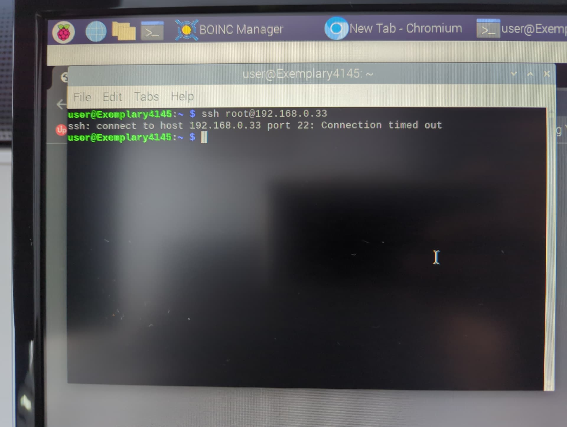

From the Raspberry's terminal, I'm entering: ssh root@192.168.0.33
but it times out, as shown in the attached image.

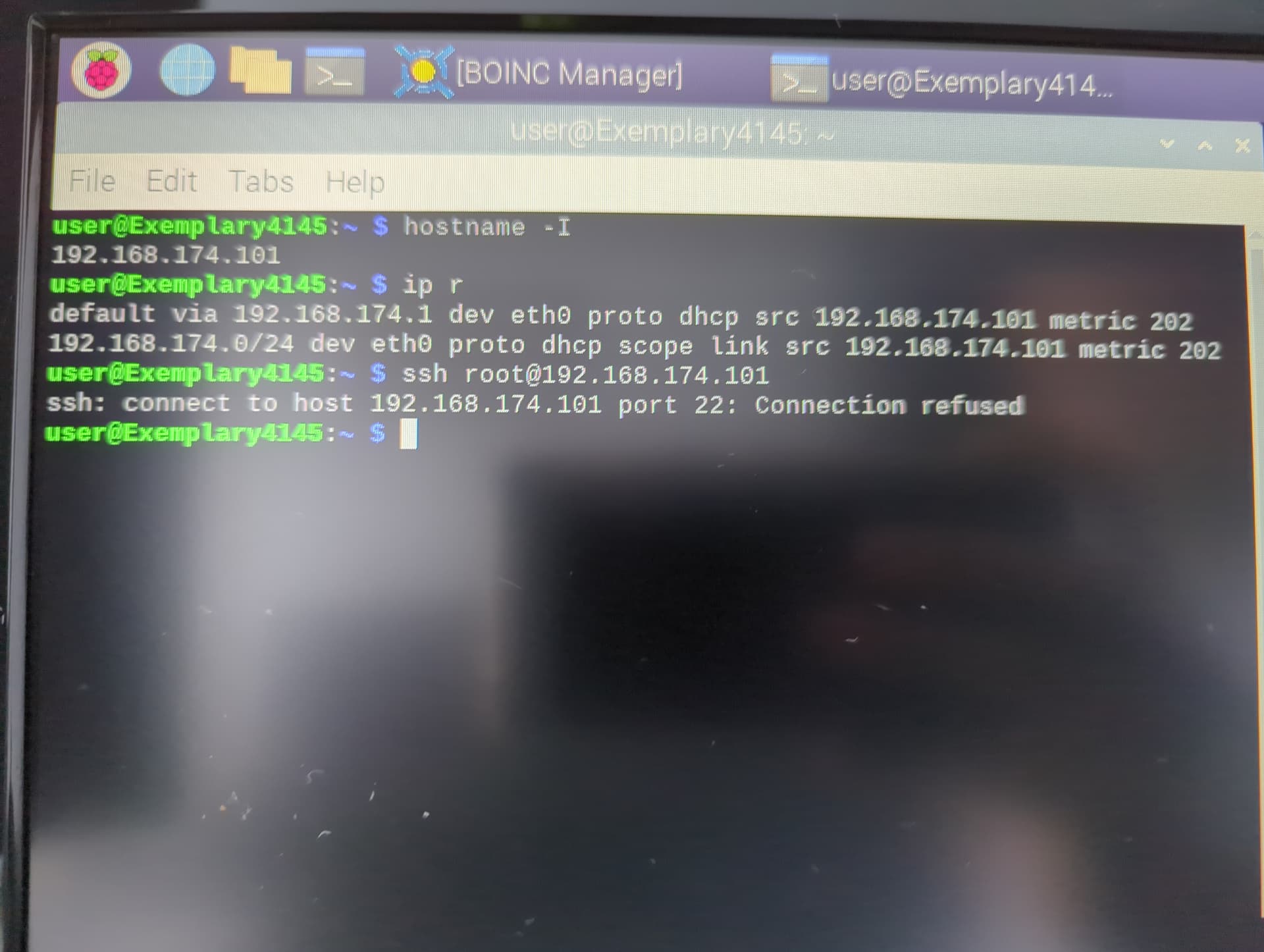

What is the output from these two commands run on the same terminal?
hostname -I
ip r
Just to confirm, the Pi in the photos is a different one to the Pi-hole Pi?
The Pi-hole was originally on the 192.168.0.x network (at .33), and the router would have also been on that network (probably at .1 or .254).
This terminal that you are on is on 192.168.174.101 and the router's IP is 192.168.174.1. These are both on the 192.168.174.x network so they will not be able to reach anything on the Pi-hole's network.

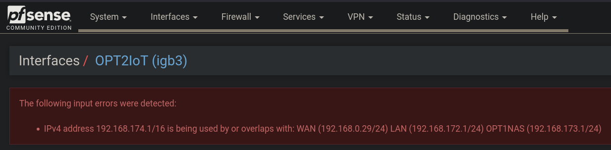

I tried changing the network's IP address to /16 but got the error from this screenshot. I don't know how to get around this. I do recall seeing a section for the subnet mask addresses but I don't remember where that was located. In either case, I'm not sure if attempting to change it would return the same error message.
Would it be simpler to reninstall Pi-hole and set everything up right this time?
