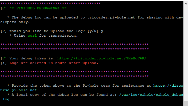

As for the debug token, when you run pihole -d, it will ask at the end of the process if you want to upload the token for developers to view. Choose yes and share the token here please - we can take a look and help you troubleshoot to get it working as expected.

Ok, after several minutes, it gave me the option to upload the debug log. Which I answered Y. Man, there is a lot of stuff in that log.

And the token code it gave you?
Lets not give up too soon, eh?
I did not see a token code. It just went back to the command line. Should I run it again?
See my earlier reply How can I revert back from v6? - #6 by chrislph
I do appreciate the help. I apologize, I don't know this term docker. Also, I started -d again and it is running now for almost a minute.
Edit: https://tricorder.pi-hole.net/3KeHoF6R

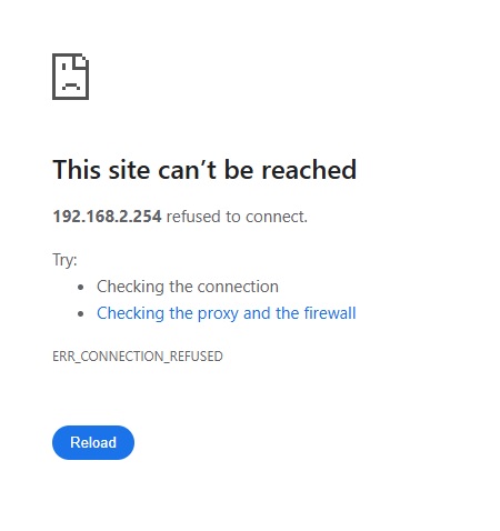

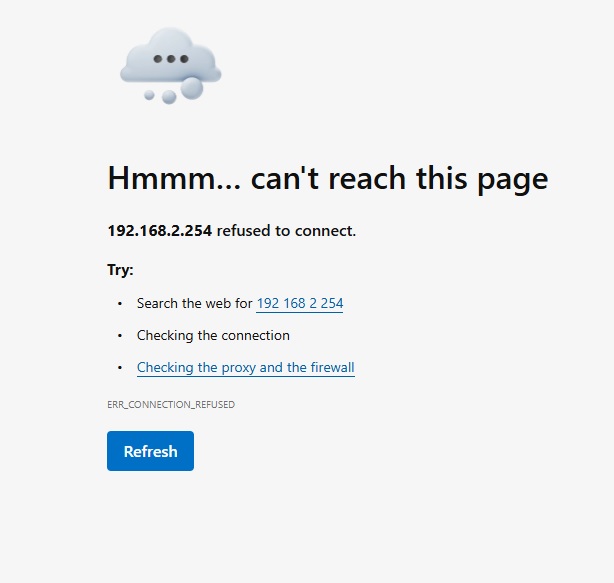

I did select YES to disable lighttpd. My browser changes http to https. I use Firefox. I disable autofill yet it still changes to https. I try Chrome (Brave), refused to connect error. I try Edge, same refused to connect error. My bookmark for Pi-hole is http://192.168.2.254/admin/ I use Microsoft Defender for anti-virus and firewall. Can that be the problem?

Well, this is going to sound a bit strange but as I have had a Pi-hole session open all morning and have been going back and forth from this discourse to the Pi-hole session, it seems as if the speed issue has gone away! Strange as it may sound, it is navigating at a reasonable speed. Did it fix itself? This leaves the main issue I have with v6 being the missing static DHCP chart and the fact that I cannot access it with http://
