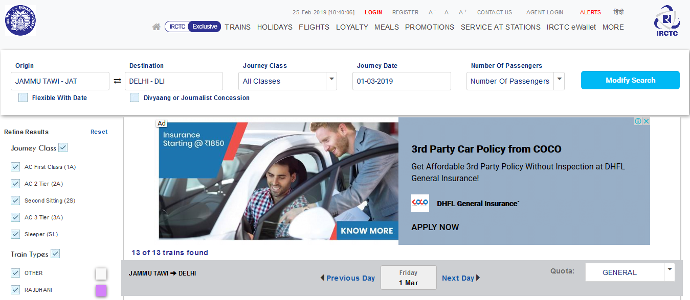

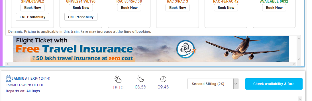

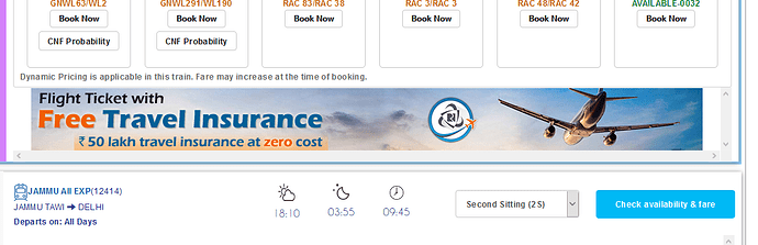

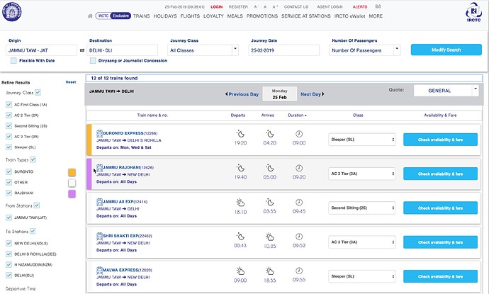

I'm talking particularly about this one website: https://irctc.co.in they're doing some weird thing and are able to load google ads even with pi-hole enabled.
The website is more of a Javascript application and they're somehow able to resolve google ads properly despite of pi-hole being enabled and used on devices. Ads on other websites do block just fine for now but this is enough of an alarm.
Example Screenshots:

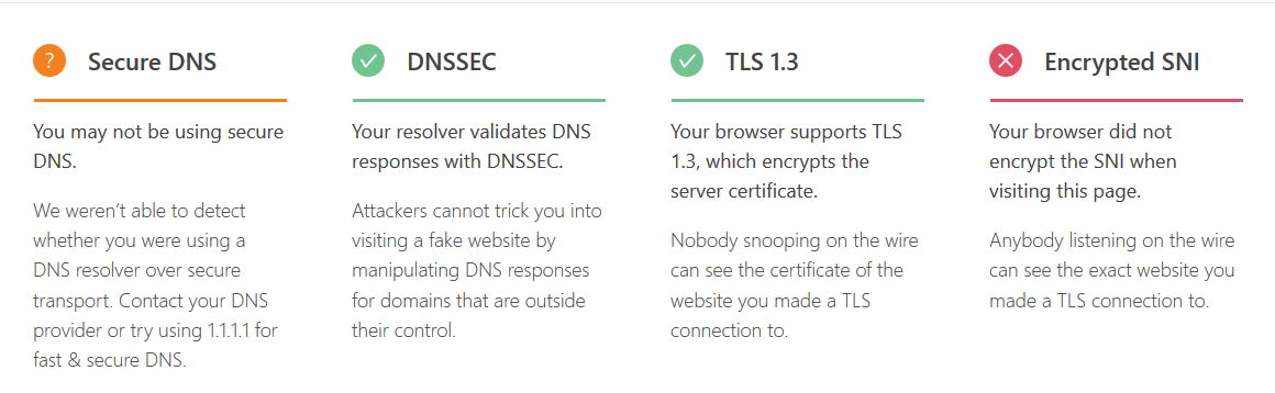

This setup didn't get me all green checks here
(I know, it isn't possible to get encrypted SNI with pihole but it also doesn't give green check for the Secure DNS thing)
What green checks are lacking?
I would go to the Cloudflare site and see if there is additional information for checking your DoH configuration and any support on this topic.
