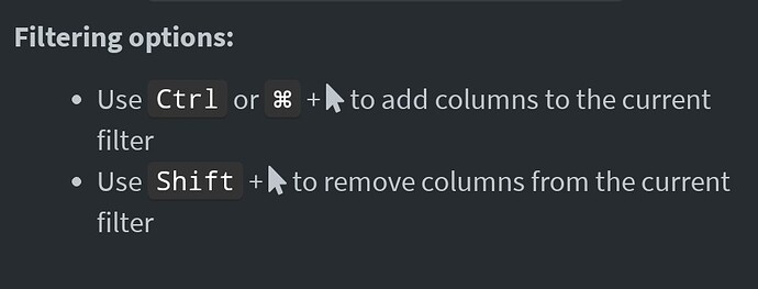

So, since the new update if you want to filter anything in the query logs you have to press control + click or shift + click.

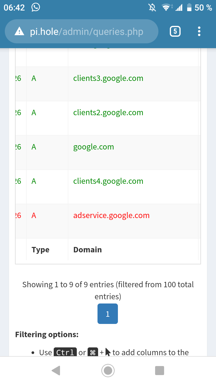

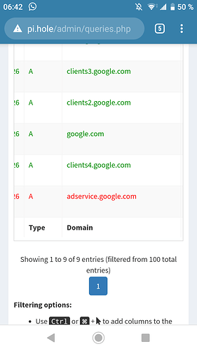

On mobiles you need to type the search term in the search window.
Searching and filtering do not behave exactly the same way. Searching is inclusive while filtering is exclusive.
See the screenshot where I searched for "Google.com"

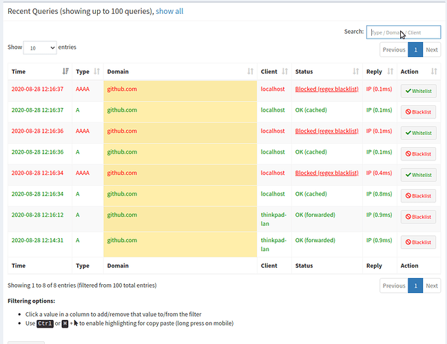

Gave this some thought this morning, and came up with the following proof of concept:
https://github.com/pi-hole/AdminLTE/pull/1568
Should allow both desktop and mobile users to enjoy the new filtering, with or without a keyboard.
Keep in mind, this is still a draft/WIP but just to give an idea.
Initial testing on dektop and mobile worked very well.

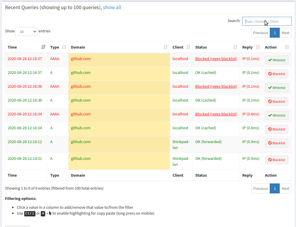

Does not go well with the link for "Blocked (regex blacklist)
Ah, yes, it probably does not. This was probably the thinking behind the modifier key. Back to the thinking room....
Can you distinguish if users click directly on the link text or only in the surrounding box?
Yeah I was just thinking something along these lines. One would have to be very accurate with their clicking, which can be a pain on mobile.
Yeah right...
Adding a small button/icon in the regex box which links to the regex list? Then the easy "default" would be the filtering, and only for detailed regex info users had to aim very precisely.
Keep it as it is. Do not make it harder to use this on the desktop where real research into things may happen.
