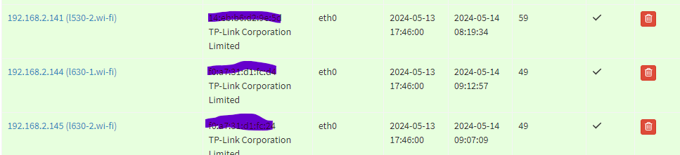

Host name of client xxx => contains (at least) one invalid character at position 0
Because:
192.168.2.141	l530-2	14:eb:b6:d2:9e:5d	in 21 minutes
I then assumed this indicated lease was renewed.
I am a clown :clown_face: I forgot to enable when I reinstalled the PI OS and Pi-hole on the new memory card.
My bad - apologise!
Enabled now!
Absolutely - will do!
You've shown us DHCPREQUEST and the following DHCPACK above, but
means: it expires in 21 minutes, nothing else.
To me, it looks like
  1. The devices gets a DHCP lease
  2. At some point it expires
  3. Now the hostname is undefined (<-- bug)
  4. The device may register a new lease at some point.
If the devices are behaving correctly and are constantly on, I'd expect renewing to happen between 1. & 2. causing 3. to never occur in the first place.

For the above two I don't see either of them under Currently active DHCP leases, not sure why as I assumed they would be shown.
Any news? I guess no news by now means the fix is working as expected :slight_smile:
Hi @DL6ER,
So far all appears OK.
I have changed the lease time a couple of time from short to long (12h) and back to short now 30 min.
The 3 devices with issue appears fine now.
