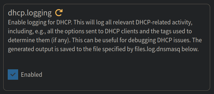

Do you still have the config option dhcp.logging set to true ?
I'm asking because - in one log snippet above - we have seen the underlying DHCP activity but not in the more recent ones:
Could you grep your logs specifically for dnsmasq-dhcp + some IP address where you notice the error next time?
