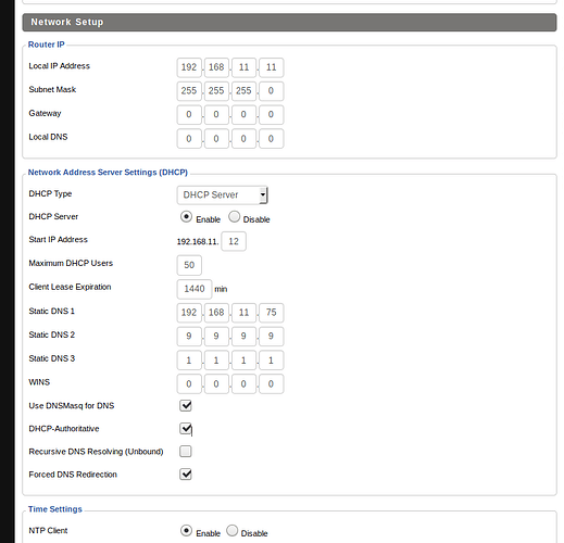

The setting on my dd-wrt router are as follows: ( also see attached screenshots)
DHCP server: enabled
router IP address is 192.168.11.11
Static DNS1: 192.168.11.75 ( this is the pihole ip address)
Static DNS2: 9.9.9.9
Static DNS3: 1.1.1.1
Use DNSMasq for DNS: enabled
DHCP-Authoritative: enabld
Forced DNS redirection: enabled
Under the SERVICES tab:
I have Dnsmasq enabled
No DNS Rebind enabled
Query DNSin strict order enabled
Additional Dnsmasq Options: dhcp-option=6,192.168.11.75
DHCP IP Range is :
Start IP Address
192.168.11.12
End IP Address
192.168.11.61

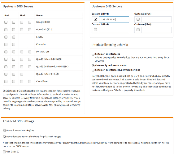

The pihole settings are attached. DHCP is disabled on the pihole.
Only custom DNS is selected on the pihole interface and it is set to the router's IP address
What I am trying to achieve is to have the pihole display each client individually on its web interface.
And if anyone might have a clue why the pihole web interface is extremely slow when loading or sometimes does not load at all.
Thank you all in advance for the help. Much appreciated
Your additional Dnsmasq setting conflicts with the other DNS settings. It says to only send the Pi-hole’s IP for DNS, while the other settings say to use multiple IP addresses. Try disabling Dnsmasq (including “Use DNSMasq for DNS”) and only using Pi-hole for DNS.
Why do you have the Pi-hole forward queries to the router? It can directly use whatever external DNS server you want.

  3. Finally, I would like to use a third party DNS for my upstream but the third part DNS is not listed as one of the "Upstream DNS Servers" on the pihole's Web Interface under DNS tab.
Thank you in advance
  1. If you set up the DHCP on the router properly, then all connected clients will receive the DNS of Pi-Hole and nothing else. This is the normal method.
  2. If your router supports it, the IP of each client will be shown in Pi-Hole. You may have to use conditional forwarding in the Pi-Hole. Another option is to use the Pi-Hole as your DHCP server (this will solve problems 1 and 2).
  3. You can list any upstream DNS server you want in the custom fields. Example shown below for unbound on a local port. For commercial upstream servers, use port 53 at the end, not 5353.

I tried to disable dhcp on the router and enabled it on the phole but I ran into a problem where smartphones could not obtain an IP address and could not get internet, however, all other devices, like PC, TV, PS4 were able to obtain an IP address.
Also, I could not make the pihole to use the DNS servers that I specified in the Custom Upstream DNS server. I used two custom DNS servers in Custom 1 and Custom 2 but the pihole kept on using the ISP DNS.
Sometimes when I ran a DNS test I saw a mixture of DNS servers being used in the results. It contained the two custom DNS servers I plugged into the pihole as well as the ISP DNS.
Any idea on these two issues?
