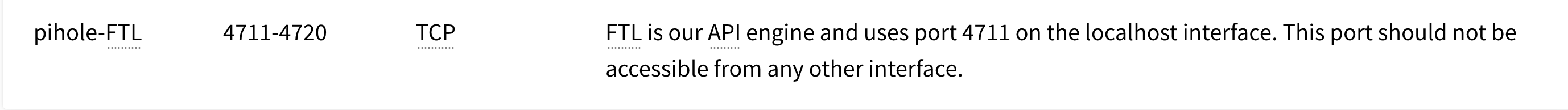

I see, but from the documentations, it's stated that
FTL is our API engine and uses port 4711 on the localhost interface. This port should not be accessible from any other interface.
so I would assume that it's safer to limit our firewall's permissiveness to reduce the possible attack surface?
However, thanks to reply@Bucking_Horn I've been made aware of Pi-Hole's required ports documentation and realized that we should probably allow all ports ranging from 4711-4720? So our new command would look like this:
sudo ufw allow from 127.0.0.1 to any port 4711:4720 proto tcp
Did I get it right?

I've noticed that the firewall docs for UFW doesn't restrict connections to just the local network. I guess this would be fine if you don't port forward from your router but in my opinion, hardening a firewall would be to set more definitive rules in place I guess?
Oh and one more thing, does anyone know why pihole-FTL's ports 4711-4720 is not explicitly allowed in the UFW docs?

If want to post generic firewall rules to cater for everyone, like Bucking_Horn suggested, I would allow the whole IPv4 127.0.0.0/8 subnet + IPv6 ::1 .
We only use 4711, there is no auto-ranging anymore.

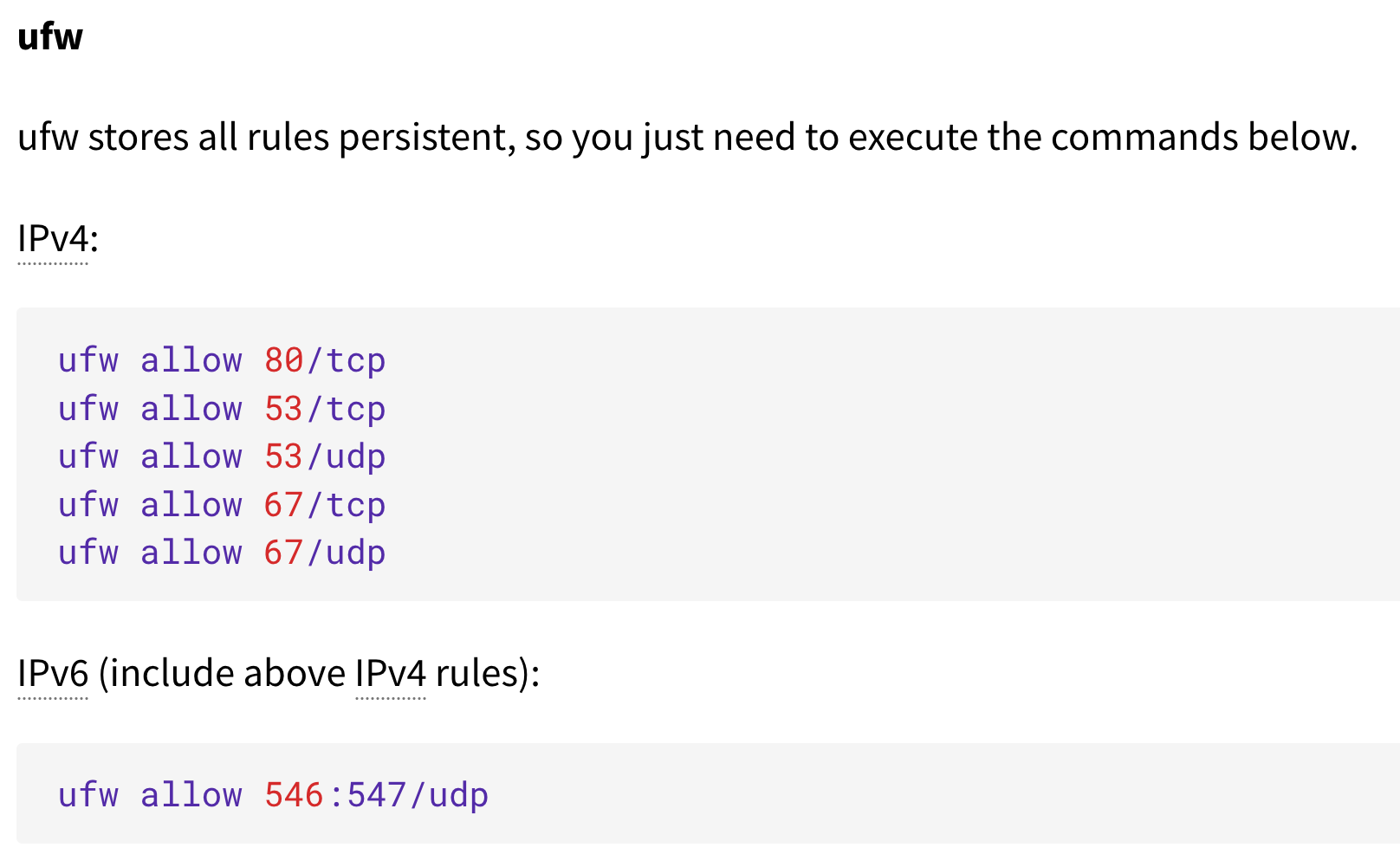

are the ufw rules in this article https://docs.pi-hole.net/main/prerequisites/#ufw up to date ? The SSH port isnt even mentioned... someone could update the ufw part in the prerequisites.. Also what about the Port 4711 ?
Why should SSH or 4711 be added?
well u are right the ssh port is not necessary at all but still could be mentioned.
i just thought of this:
sudo ufw allow from 127.0.0.0/8 to any port 4711 proto tcp
isn't it necessary to allow it for the localhost?
