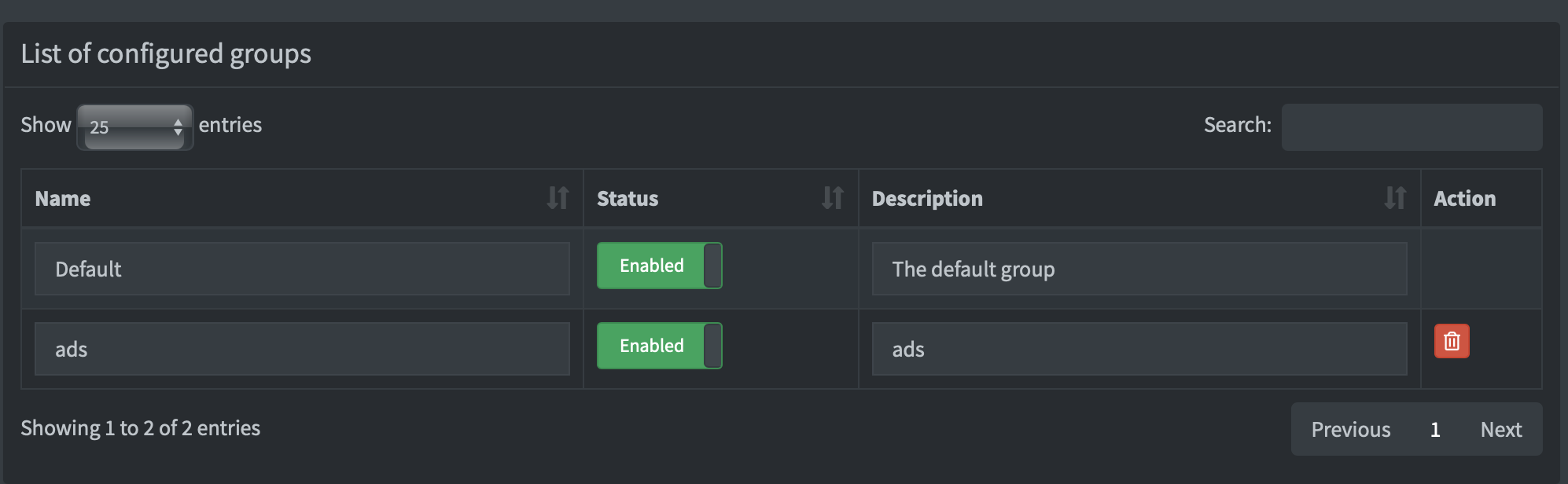

Using Pi-hole group management I want to create groups that have certain domains whitelisted. I just started with creating a group that has no blocklists applied to it called ads.

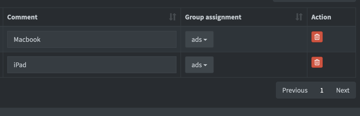

I've set two devices to have static ip addresses as clients for this test group.

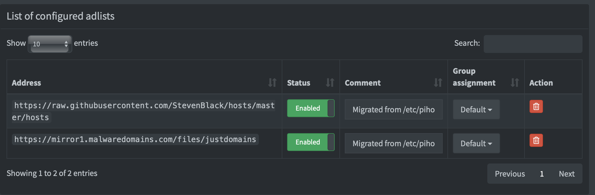

Groups:
Clients:
Adlists:

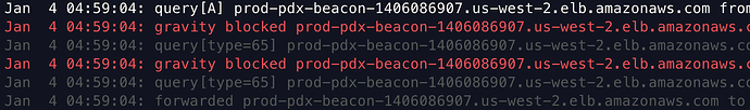

I ran tests on these two clients in the ads group, where I would open up the log using pihole -t and then go to a website with lots of ads. The query log would quickly fill up with requests from their respective ip addresses, but it seemed they were still being blocked by gravity.
I thought perhaps this was an issue with the router ip being the only one making requests, but the query log does show these device IPs. The client IPs are grayed out compared to the white of the IP requests from the router. Possibly an issue with an eero mesh setup?
It kind of seems there is some forwarding going on.
Reference on the color coding in the terminal:
White being the router IP, red being blocks, and gray being forwarding / responses / IP of the client.
Actual example from log:
Jan  4 04:59:04: query[A] sync-t1.taboola.com from *Router ip*
Jan  4 04:59:04: gravity blocked sync-t1.taboola.com is 0.0.0.0
Jan  4 04:59:04: query[type=65] sync-t1.taboola.com from *Router ip*
Jan  4 04:59:04: query[type=65] sync-t1.taboola.com from *One of the Client's ip*
Jan  4 04:59:04: forwarded sync-t1.taboola.com to 8.8.8.8

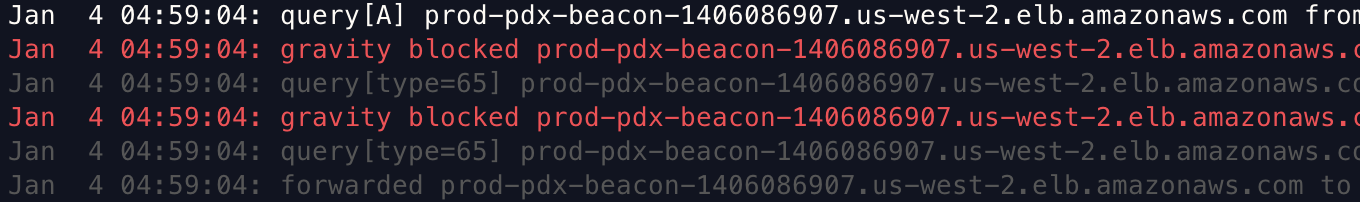

It seems your clients are using your router as DNS server (at least your mac client does), i.e. they are sending DNS requests to your router, and your router is then forwarding them upstream to Pi-hole.
Pi-hole is seeing those requests as originating from your router.
Presumably, your router is Pi-hole's only client.
For Pi-hole's client-based filtering to work, your clients have to use Pi-hole as DNS server so that they are sending DNS requests directly to Pi-hole.

Just wanted to add a note that my ultimate solution to this was to hardcode the DNS server of devices that needed to go into groups. The eero does override and make the requests come from its IP unless you hardcode the devices DNS to point directly to the Pi-hole.
