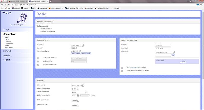

I'm not familiar with Gargoyle routers. Can you send a screenshot of where you are setting the DHCP options for the DNS?
Heres the page where I configured the DNS... but from what Ive been told, the option I need to change is not available via the web interface... !

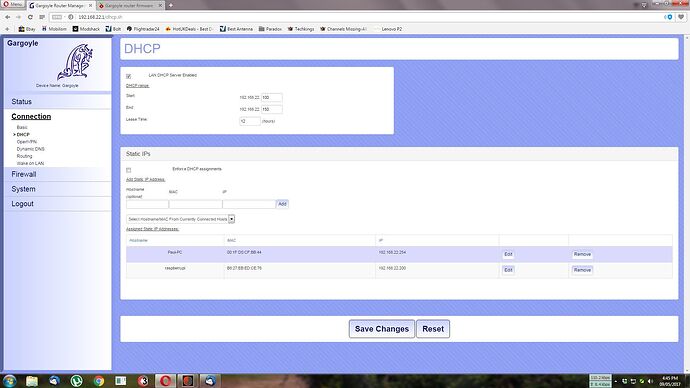

Can you send a screenshot of the DHCP section from the sidebar?
That seems to be correct then. However, the perfect solution to your problem is to use Pi-hole's built-in DHCP server.
