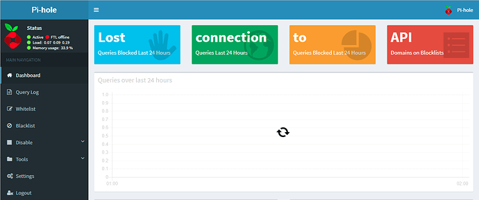

I get this when I open my admin page
and this is the response to your request:
