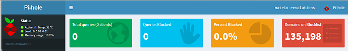

wow after restart FTL is working
but ......
no blocking no queries ...... :frowning:
First get ride of above setting as it doesnt belong to Pi-hole and might conflict with other Pi-hole settings.
Edit the file /etc/dnsmasq.conf and remove or hash out the dhcp-range= line.
Restart FTL and check again:
sudo systemctl restart pihole-FTL
sudo systemctl status pihole-FTL -l
