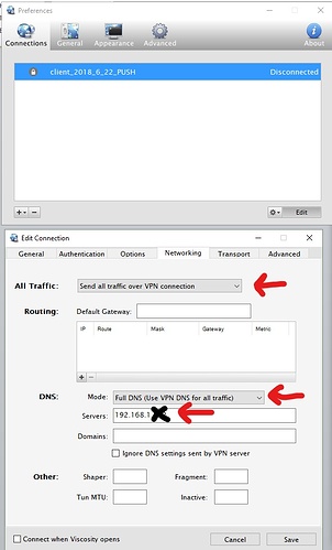

I've had trouble, too, with this, esp with Macs, which my daughter uses. In case you're using Viscosity with OpenVPN, here's an image showing the settings within Viscosity that seem to have eliminated the DNS problem with the Mac:
