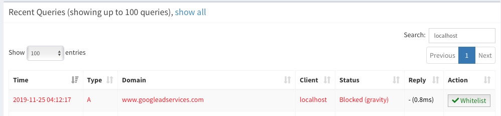

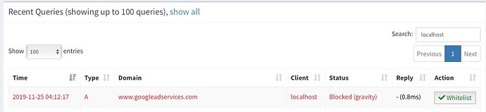

This information is presented in the Pi-Hole query log on the web admin GUI. On each line, you see the time, type of query, requested domain, requesing client, status and reply. If you click on the client, the output filters on that client. Is this not the information and format you are looking for?
Matching lines in /var/log/pihole.log for this query
Nov 25 04:12:17 dnsmasq[723]: query[A] www.googleadservices.com from 127.0.0.1
Nov 25 04:12:17 dnsmasq[723]: /etc/pihole/gravity.list www.googleadservices.com is 0.0.0.0
