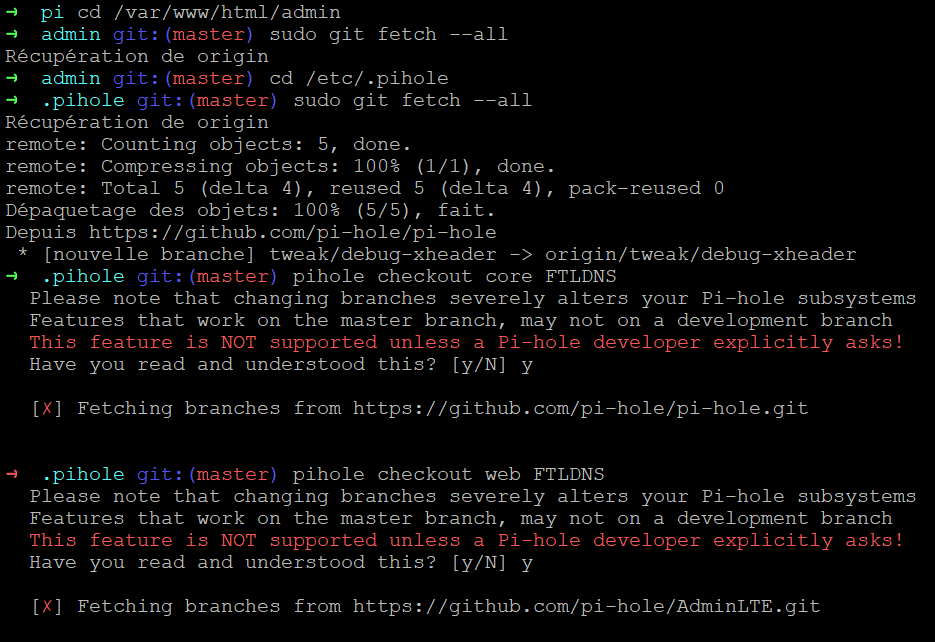

Fetching branches fails
I'd be glad to help beta test this brand new FTLDNS but can't get the new branch to download.
Of course I have the git client installed on my Raspbian Stretch, everything is up-to-date, here's what I get when running the above commands :
What did I miss ?
(In case this is relevant, I precise my current Pi-Hole is configured with Dnscrypt-Proxy 2.0.7 / DNSSec disabled using this doc and runs flawlessly : https://github.com/pi-hole/pi-hole/wiki/DNSCrypt-2.0)

OK, using the /etc/.pihole directory went OK, but the pihole checkout out commands still fail :

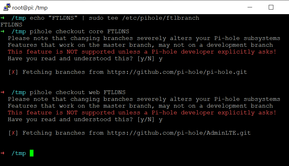

I uninstalled Pihole completely (including package dependancies), then reinstalled it and got a new Pihole install up in no time, chose Google DNS and kept default config for everything else, checked everything was runing smoothly, which was the case.
Then I tried to switch to beta version using the same commands :
echo "FTLDNS" | sudo tee /etc/pihole/ftlbranch
pihole checkout core FTLDNS
pihole checkout web FTLDNS
But again same problem as described in my first screenshot.
