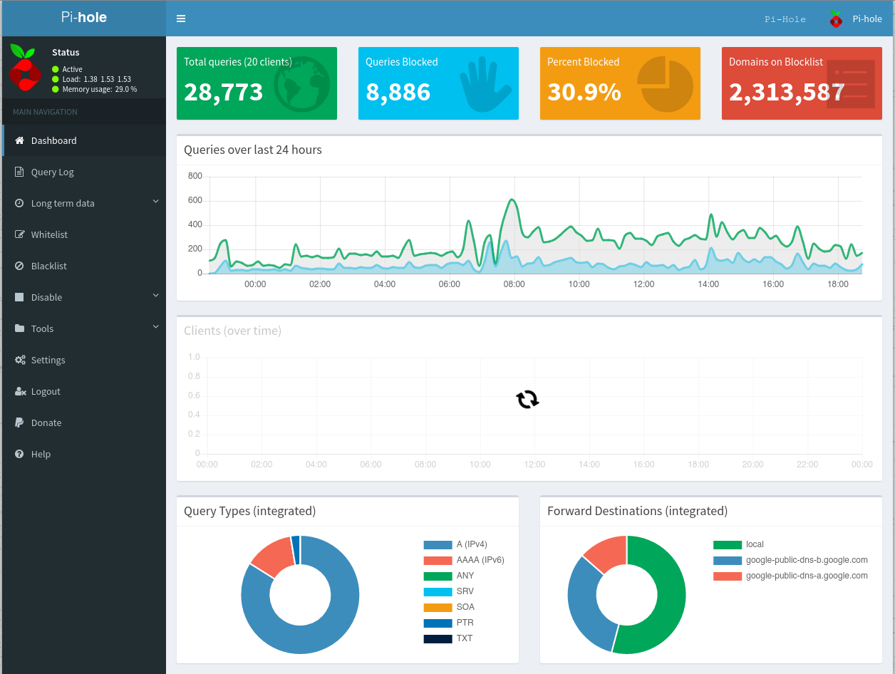

I upgraded from the most recent pihole release to the FTLDNS and the Clients(Over Time) chart does not load. I'm using Fedora 27 in an X86_64 VM. No issues before this.
Expected Behavior:
Clients (Over Time) chart should load.
Actual Behavior:
Clients (Over Time) chart has spinning arrows and does not load statistics.

I'm having a similar issue.
Ubuntu 17.10 server
FTLDNS
I've tried clearing cache and cookies in browser.

Edit 2: screenshot.

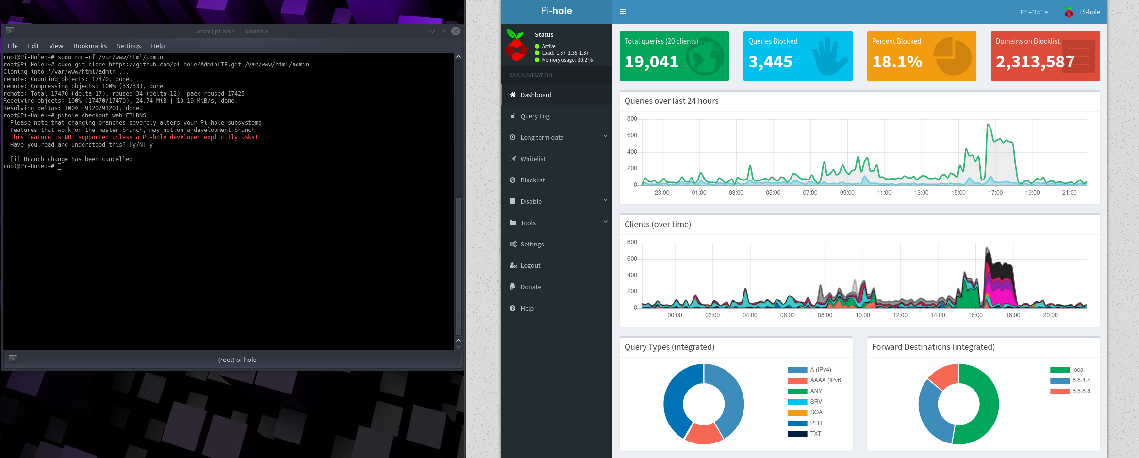

I don't usually like the nuclear option, but try this (it will wipe out any customizations you have in the Web interface):
sudo rm -rf /var/www/html/admin
sudo git clone https://github.com/pi-hole/AdminLTE.git /var/www/html/admin
pihole checkout web FTLDNS
I had literally just installed it fresh and new, on a brand new Ubuntu 17.10 CT under Proxmox. I don't think it was 'alive' for more than 15 minutes, total.
Nuclear option took care of it, we're golden!
I have to assume something didn't setup right with the switch to FTLDNS in the web interface. No idea what, but this took care of it. Thanks!
