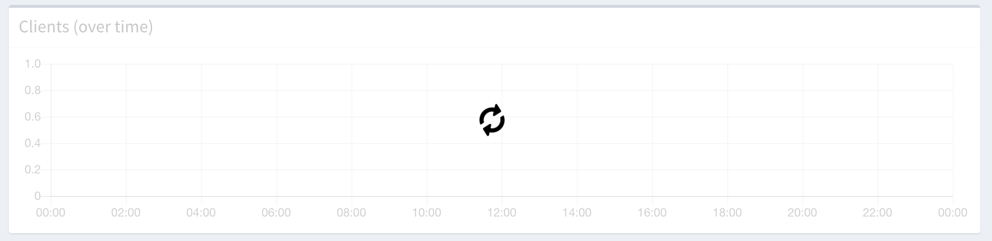

Clients over time doesn’t update, just sits there with the spinning
Updated, only problem I have is the clients over time doesn't update, just sits there with the spinning arrows

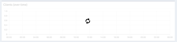

Cleared the logs, tried icognito in Chrome, tried Firefox, no dice.
Reverted back to master and it updates as expected.
Running it on an Intel Nuc, Ubuntu 17.10

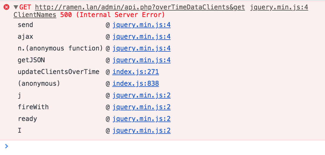

Edit: Forgot to check with Chrome developer tools, getting a 500 error for some reason:
Running incognito should negate the need to flush the browser cache I would've thought?
In any case, I tried with Firefox (which is a browser I've never used to access the dashboard) in addition to another computer entirely that I've never accessed the dashboard with either
All exhibit the same problem unfortunately
From /var/log/lighttpd/error.log:
2018-03-27 12:41:30: (mod_fastcgi.c.2543) FastCGI-stderr: PHP Fatal error: Uncaught ArgumentCountError: Too few arguments to function resolveHostname(), 1 passed in /var/www/html/admin/api_FTL.php on line 308 and exactly 2 expected in /var/www/html/admin/scripts/pi-hole/php/FTL.php:143
2018-03-27 12:41:30: (mod_fastcgi.c.2543) FastCGI-stderr: Stack trace:
2018-03-27 12:41:30: (mod_fastcgi.c.2543) FastCGI-stderr: #0 /var/www/html/admin/api_FTL.php(308): resolveHostname('192.168.1.149')
2018-03-27 12:41:30: (mod_fastcgi.c.2543) FastCGI-stderr: #1 /var/www/html/admin/api.php(86): require('/var/www/html/a...')
2018-03-27 12:41:30: (mod_fastcgi.c.2543) FastCGI-stderr: #2 {main}
2018-03-27 12:41:30: (mod_fastcgi.c.2543) FastCGI-stderr: thrown in /var/www/html/admin/scripts/pi-hole/php/FTL.php on line 143
