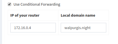

Are you aware of the conditional forwarding setting that is already implemented? It is more limited than what you propose, but it currently supports forwarding subnets such as 192.168.1.1/24.
Hello Mcat12,
I have configured the conditional forwarder with the local DNS server beforehand. The pi-hole is able to resolve not only it's own name but also the DNS servers name. Both of these devices live on the 172.16.0.0/28 network. This is a server LAN designed to keep these devices safe and only allows access to ports that are required for day to day operations. This resolution is working as intended.

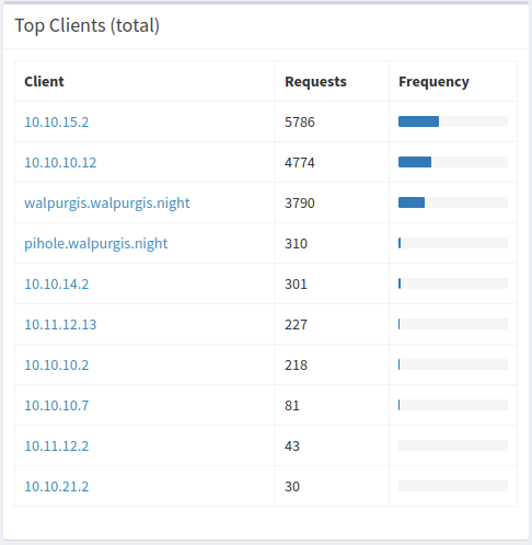

The issue I have found and the root of this request is that the pi-hole does not resolve the names for clients or any reverse lookups for private subnets that are not on the same network the pi-hole is located on. For example devices on the 10.10.10.0/24 subnet that use the pi-hole as it's primary DNS server do not get their names resolved on the clients list.
