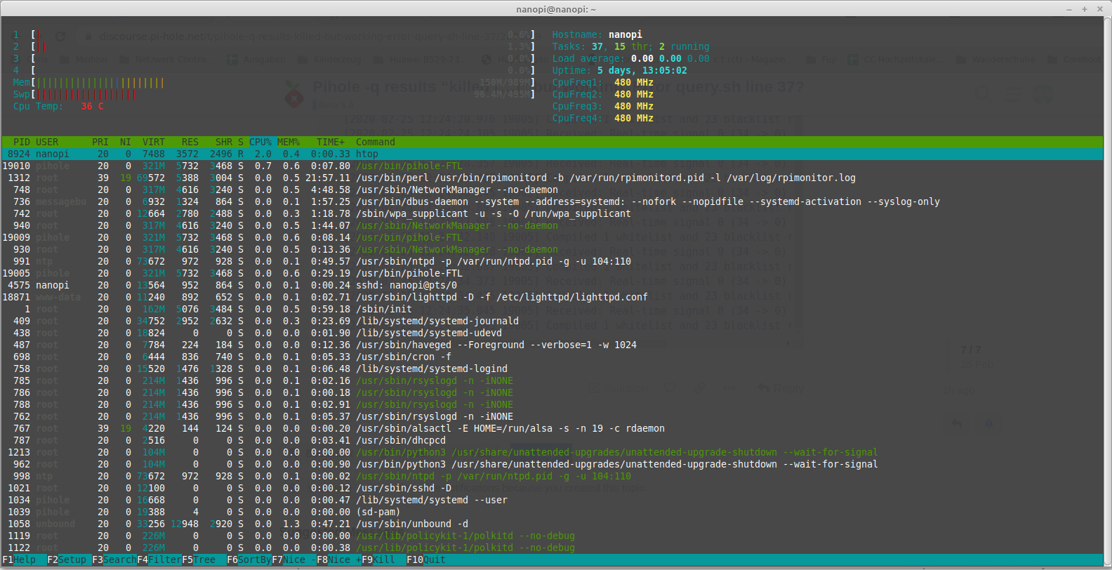

Mhh, strange. I have a NanoPi Neo Plus 2, with Pihole being the only thing running on it. 1GB RAM.
nanopi@nanopi:~$ free -m
              total        used        free      shared  buff/cache   available
Mem:            989         146         744           1          97         767
Swap:           494          95         398

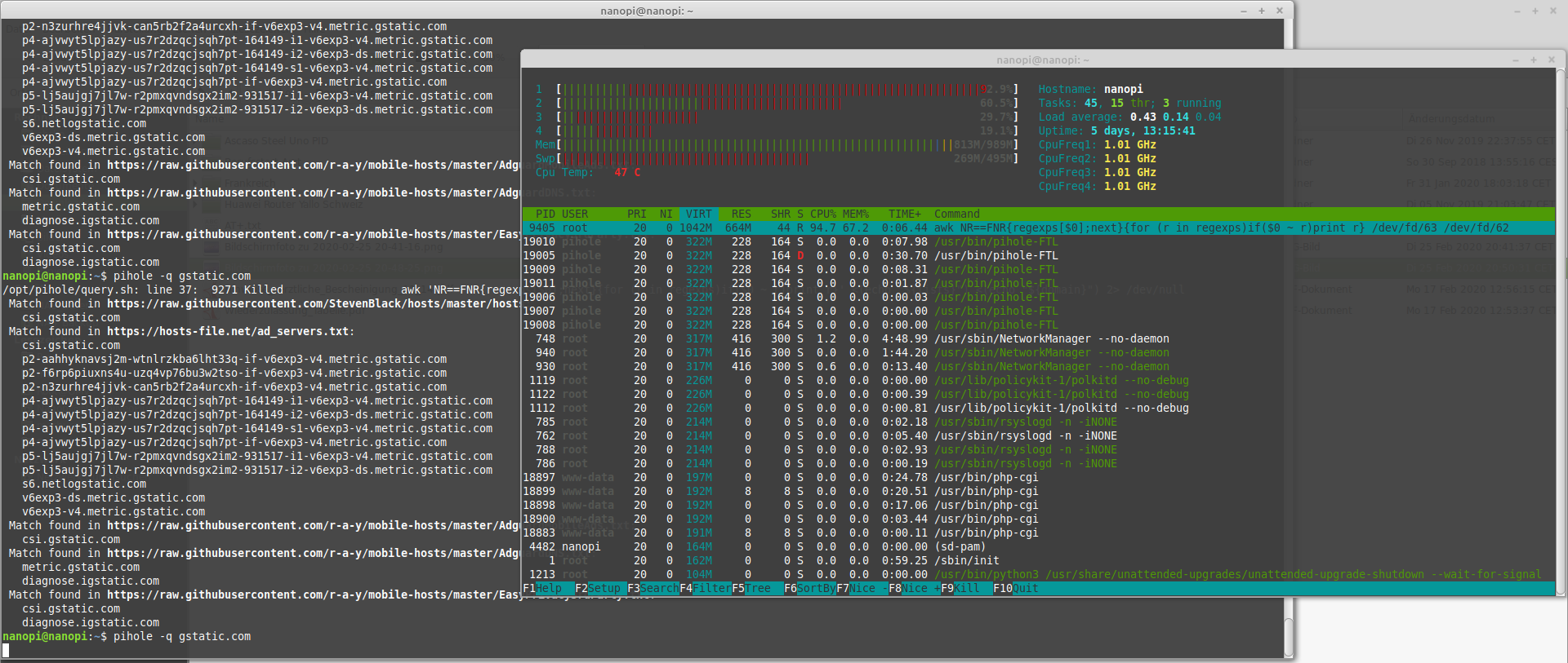

Seems like I run out of memory when pihole -q is running. It returns to normal state immediately after the process stops/is killed.

++ awk 'NR==FNR{regexps[$0];next}{for (r in regexps)if($0 ~ r)print r}' /dev/fd/63 /dev/fd/62
+++ echo gstatic.com
+ [[ 0 -ne 0 ]]
+ mapfile -t results
++ scanDatabaseTable gstatic.com gravity
++ local domain table type querystr result extra
+++ printf %q gstatic.com
++ domain=gstatic.com
++ table=gravity
++ type=
++ [[ gravity == \g\r\a\v\i\t\y ]]
++ case "${exact}" in
++ querystr='SELECT gravity.domain,adlist.address,adlist.enabled FROM gravity LEFT JOIN adlist ON adlist.id = gravity.adlist_id WHERE domain LIKE '\''%gstatic.com%'\'' ESCAPE '\''\'\'''
+++ sqlite3 /etc/pihole/gravity.db 'SELECT gravity.domain,adlist.address,adlist.enabled FROM gravity LEFT JOIN adlist ON adlist.id = gravity.adlist_id WHERE domain LIKE '\''%gstatic.com%'\'' ESCAPE '\''\'\'''
++ result=
++ [[ -z '' ]]
++ return
+ [[ -z '' ]]
+ [[ -z '' ]]
+ [[ -z '' ]]
+ echo -e '  [i] No results found for gstatic.com within the block lists'
+ exit 0
