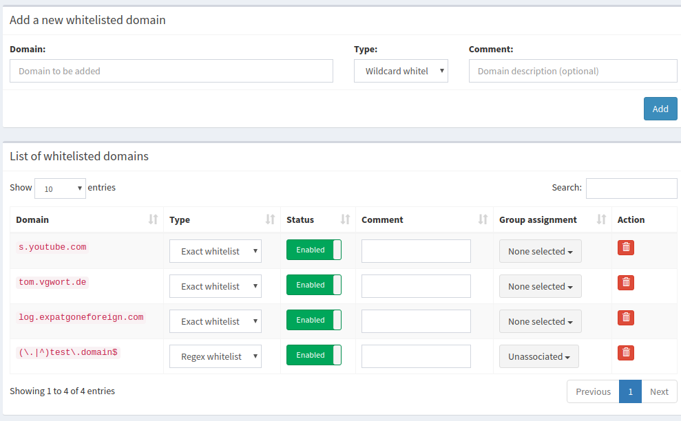

I selected "Type: Wildcard Whitelist" but it appeared as "Regex Whitelist". Not sure if it should be like this - it is automatically converted to a regex style. See picture for test.domain - it was added as wildcard whitelist but appears as Regex Whitelist.
Will do that.
Yes, that is correct. Wildcards are converted to regex value when committed.
