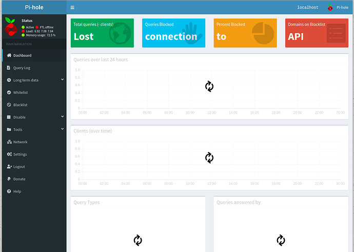

Hi, here some screenshots but are a bit generic, the same issue
as a lot of people.
I'm using a VM, exactly an Ubuntu over an Android with the app
Linux Deploy. I had in past similar issues on a Linux Mint
(Baremetal) but I'm not sure if could be the same problem because
I didn't do the debug.
  ![afkfljbjnogcgmba.png|1246x414](upload://5aMuzc7xOj6HT8iJkoehMNFl2rM.png)
Let me know if you need any additional info
  Thanks

This shows that FTL is not offline and is working normally. Those are the expected outputs.
The problem is that the web Admin interface isn't making the connection.
