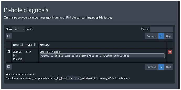

Failed to adjust time during NTP sync: Insufficient permissions
Getting this as of todays update.
Seems that your Pi-hole failed to force a time sync due to lack of permissions, presumably after detecting a mismatch between the latest database queries and your system's current time following a reboot.

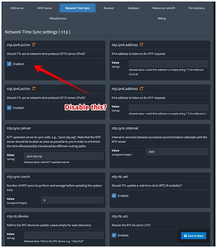

So what do I need to "turn off"? I am assuming it is something in this tab.

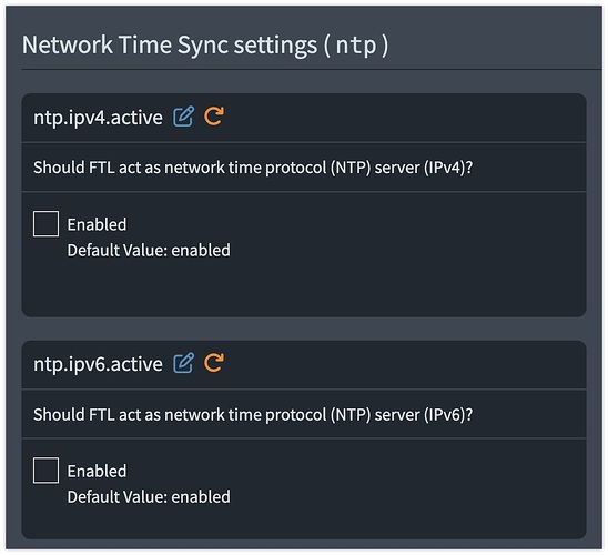

Looks like disabling these two, "fixed" it....
I hoped that it fix it, but doesn't, The error occurs again if you restart dns resolver. Looks like the config page doesn't stop to act as a local ntp server
True, not solved and I do not have to restart anything! Even after disabling the NTP options, the error keeps coming back. :frowning:
No, these are the wrong config options.
Either remove the left string (empty out the text field) or set the right value to zero - or both, like:
Ok, change it to 0. Let's see what happens. Thanks 4 the info... :+1:t3:

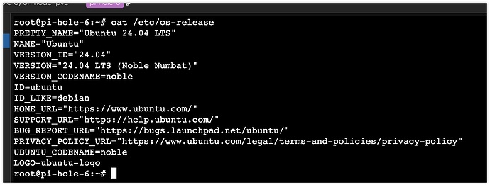

I just tested this problem still exists
Pi Hole runs under debiaqn 12 in the LXC container under Proxmox
