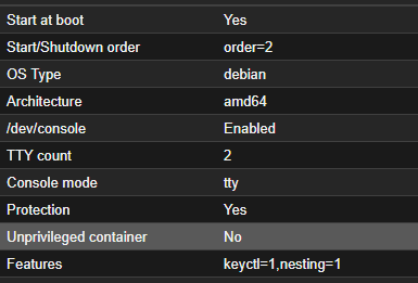

Fix for the problem under proxmox LXC
Set the container to Previligated otherwise the container would have the missing permissions
Everyone who has the container set to unprivileged has the error
changing helps
my settings:

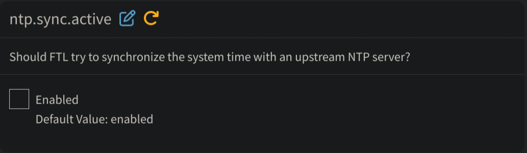

Disabling this option fixes everything.
It still allows Pi-hole to serve NTP but not go to the server to try to sync its own time with it. I guess the possibility of the host driting is possible, but in that case you can disable it acting like an NTP server on IPV4&6.
