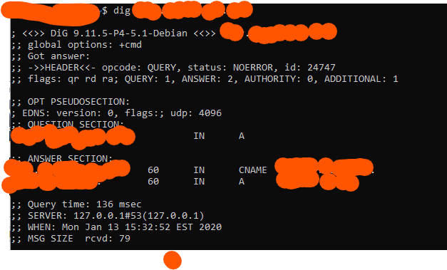

I did a dig for emby.mydomain.com (listed in the question section), the answer section says:
emby.mydomain.com 60 IN CNAME mydomain.com
mydomain.com 60 IN A my_public_WAN_IP
