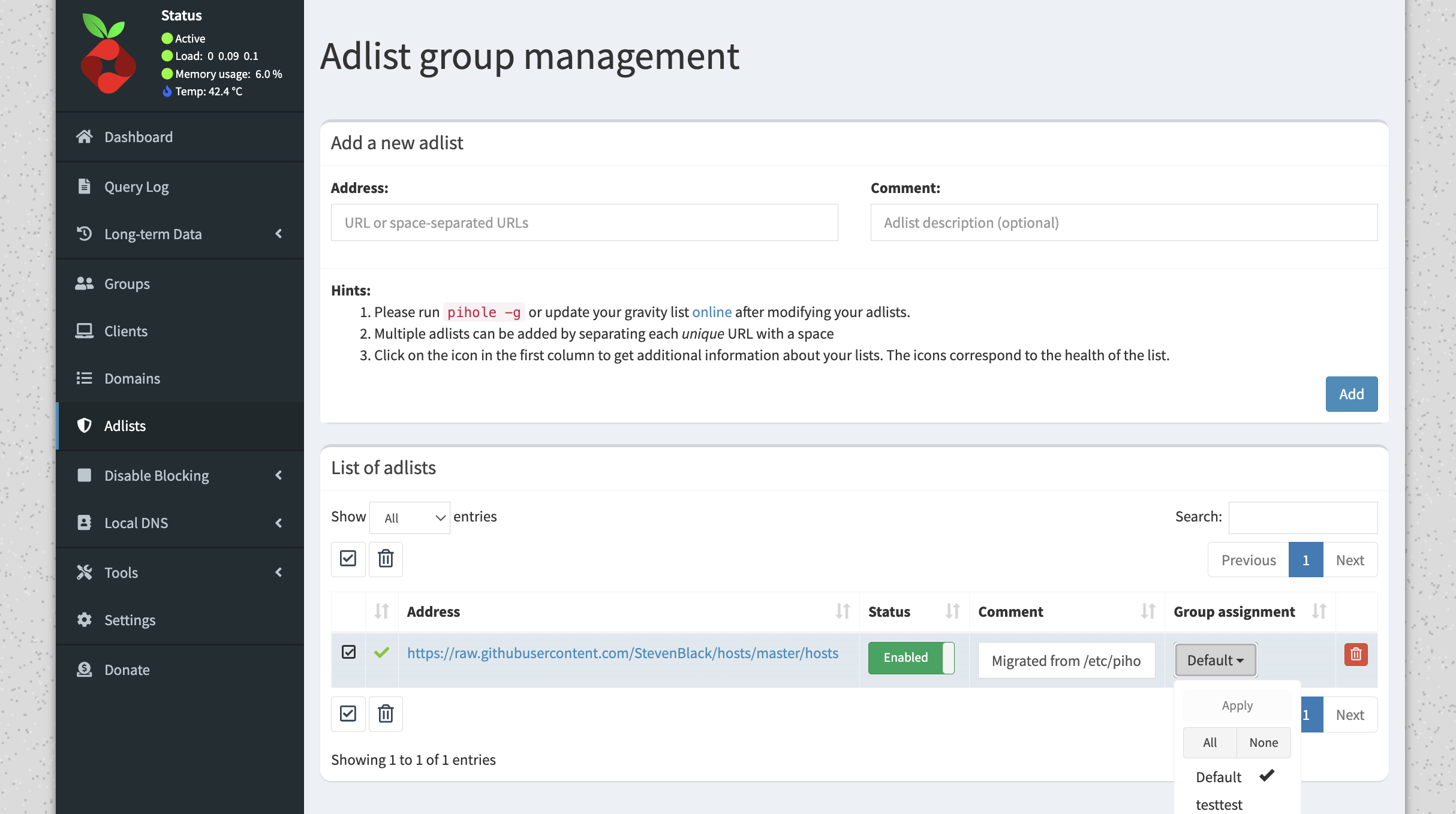

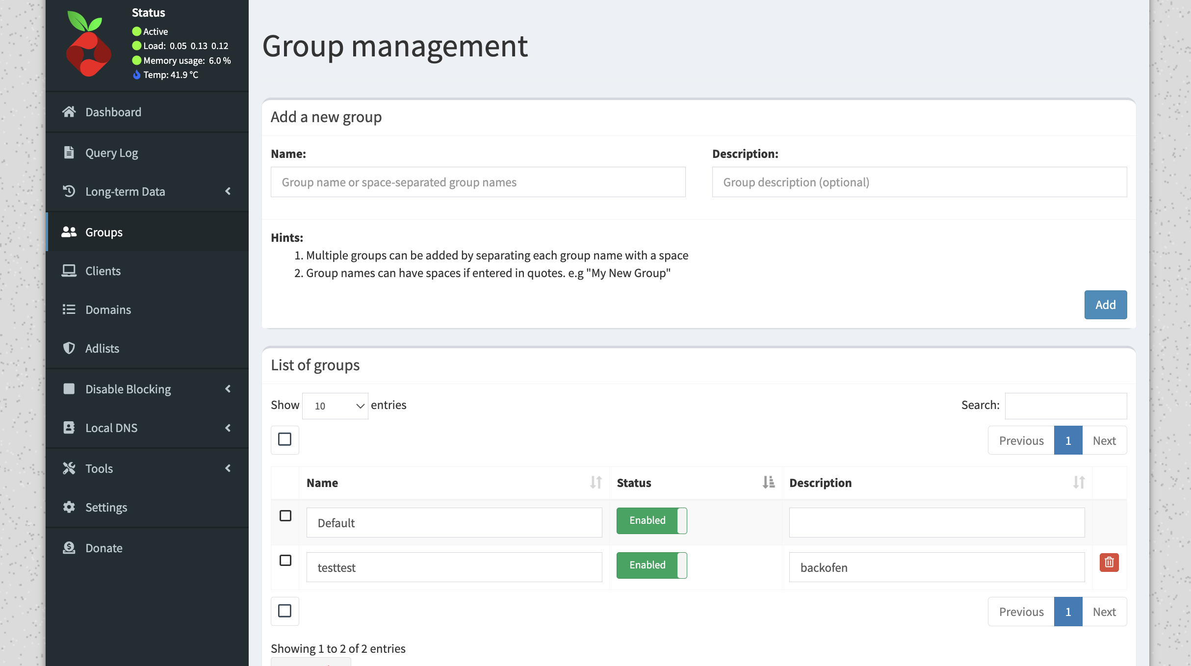

Use Group Management.
There are a few examples in our documentation. Just read and use the web interface.
i did this tutorial:
but it doesnt work.
rebootet pihole & fritzbox - still no success.
any help? Thanks in advance

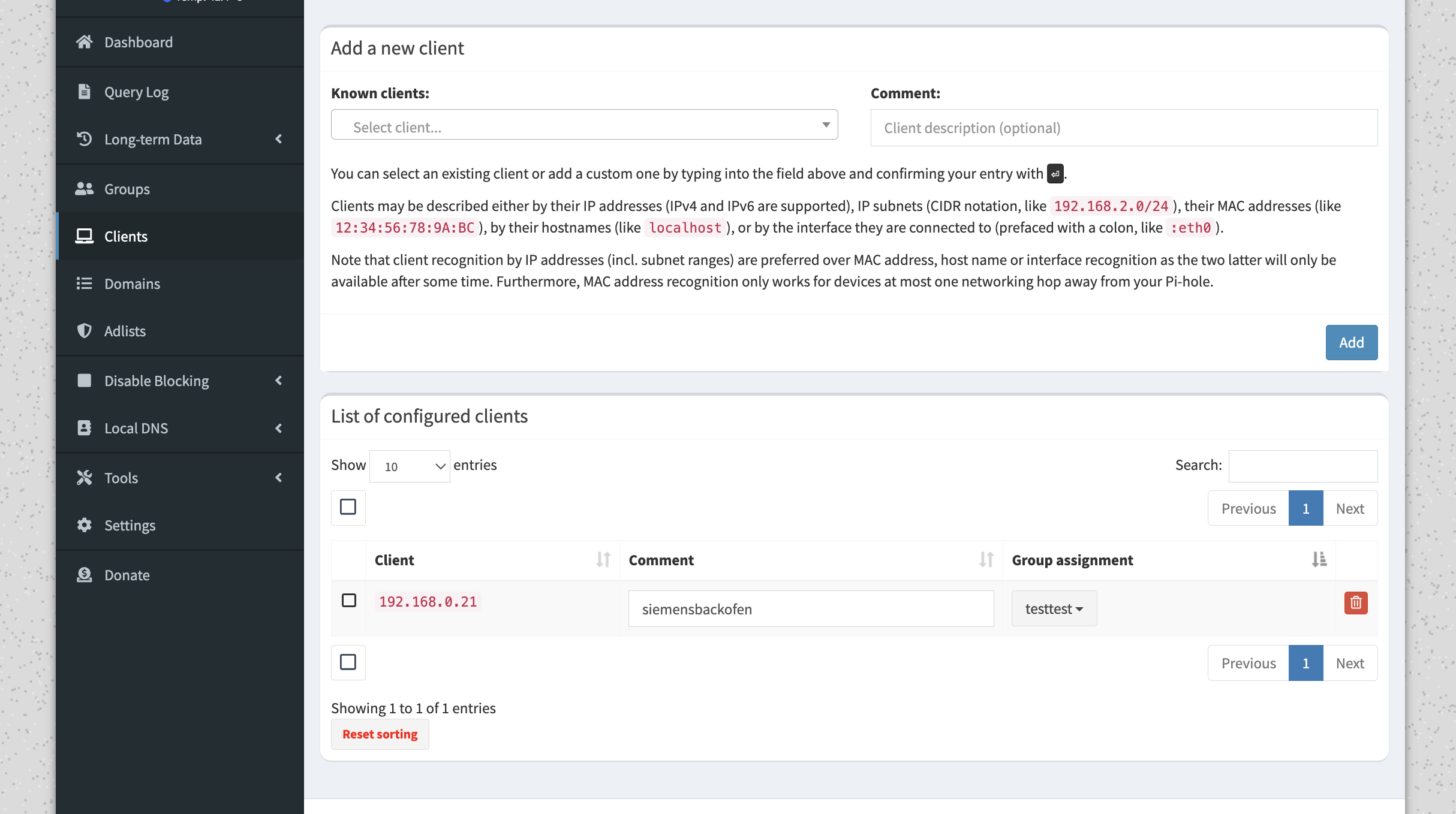

Edit: i added the 192.168.0.21 ip from the oven and the same mac adress to the exclude device (should be the same devices, to be 100% safe)

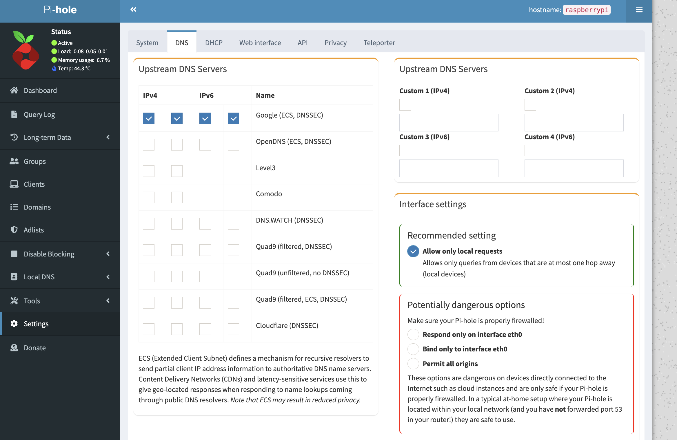

In the piholes gui under settings > DNS you should have put an upstream DNS Server ( like 1.1.1.1 or 8.8.8.8 , or perhaps something in the custom fields etc.

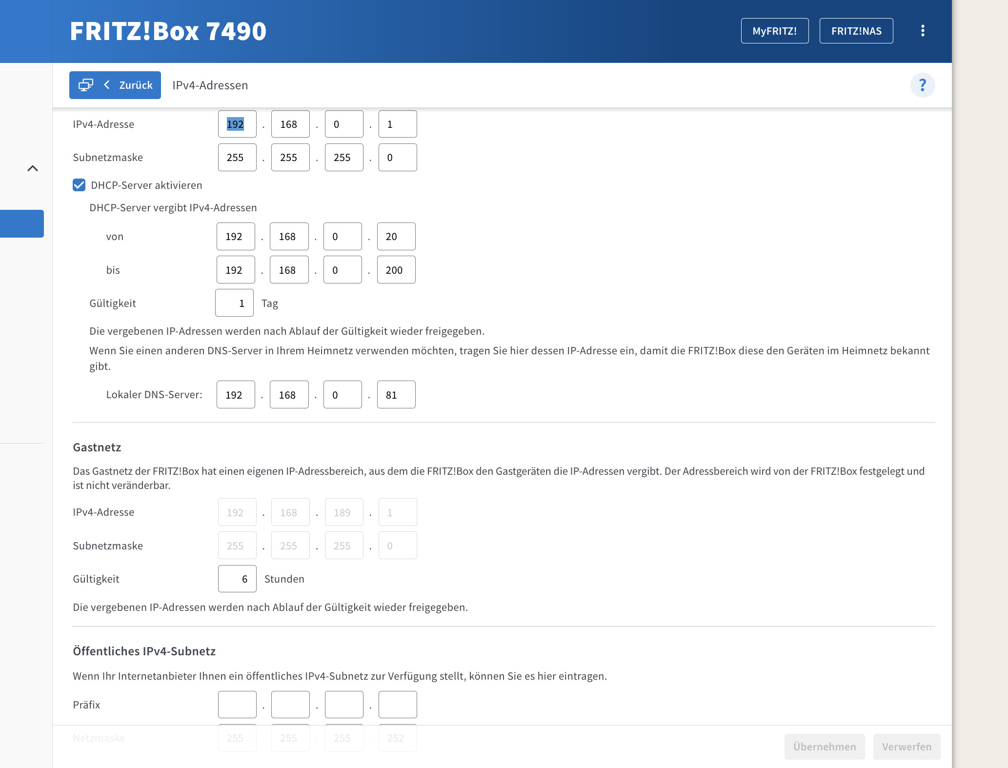

In the the Fritzbox, you originally changed the DHCP / LAN DNS servers default to the Piholes IP Address. What is that now? Are they the same?
Looking at your updated comments it seems to rule out the phone / app.
I'm not able to review your debug, only moderators / Devs can do that, but it might be interesting to see a screen shot of your Settings > DNS page for the pihole.

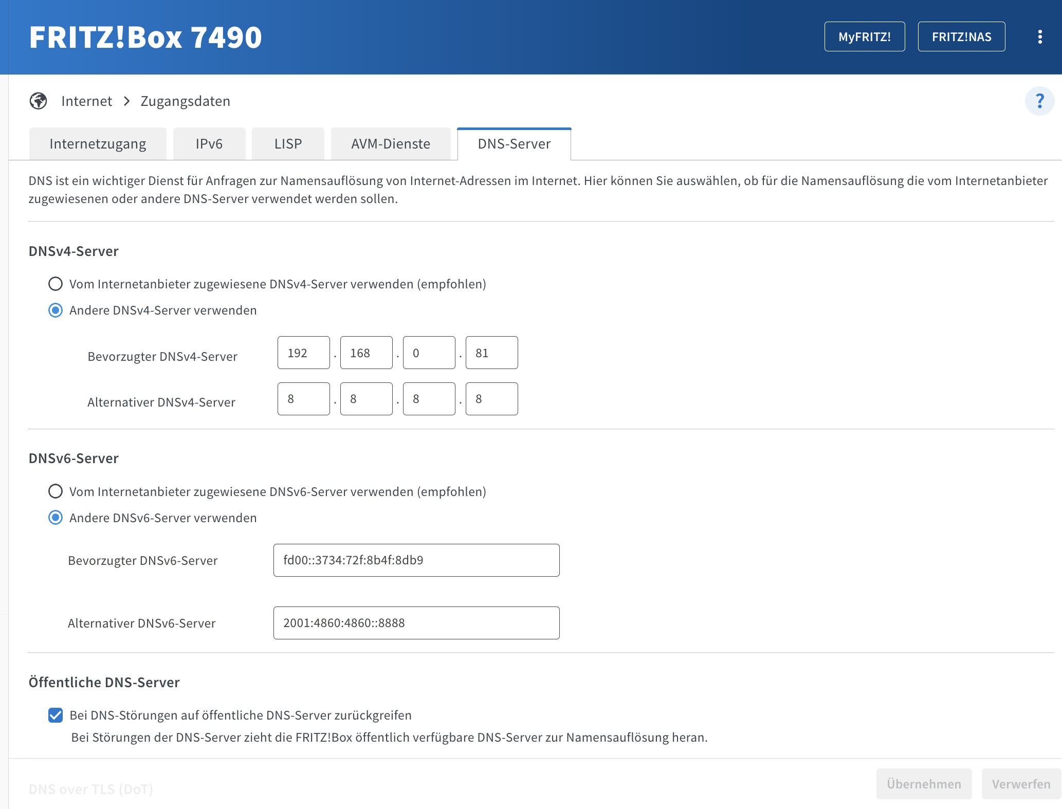

here are my fritzbox settings - 192.168.0.81 is the pihole ip:

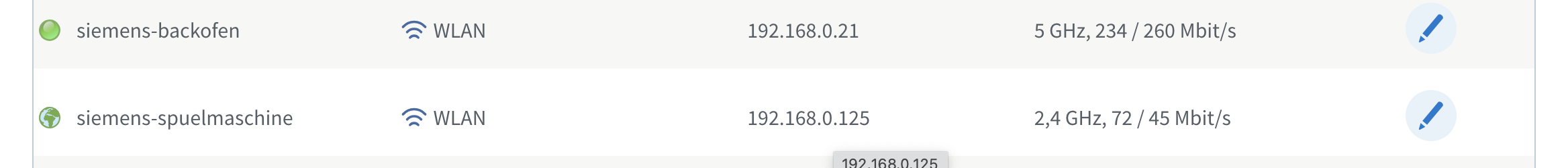

Im keep on wondering, why the oven has only a green dot and the siemens dishwasher has a global dot in front of the name (fritzbox) i have nothing blocked :slight_smile:

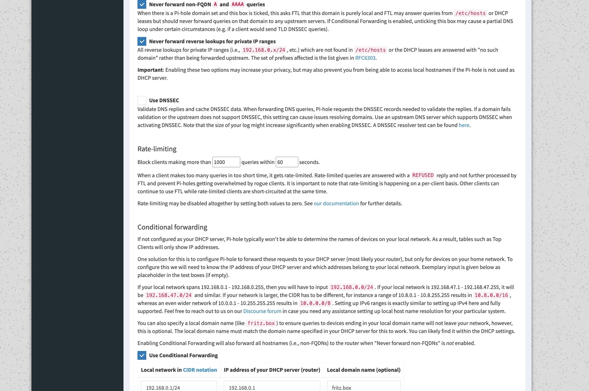

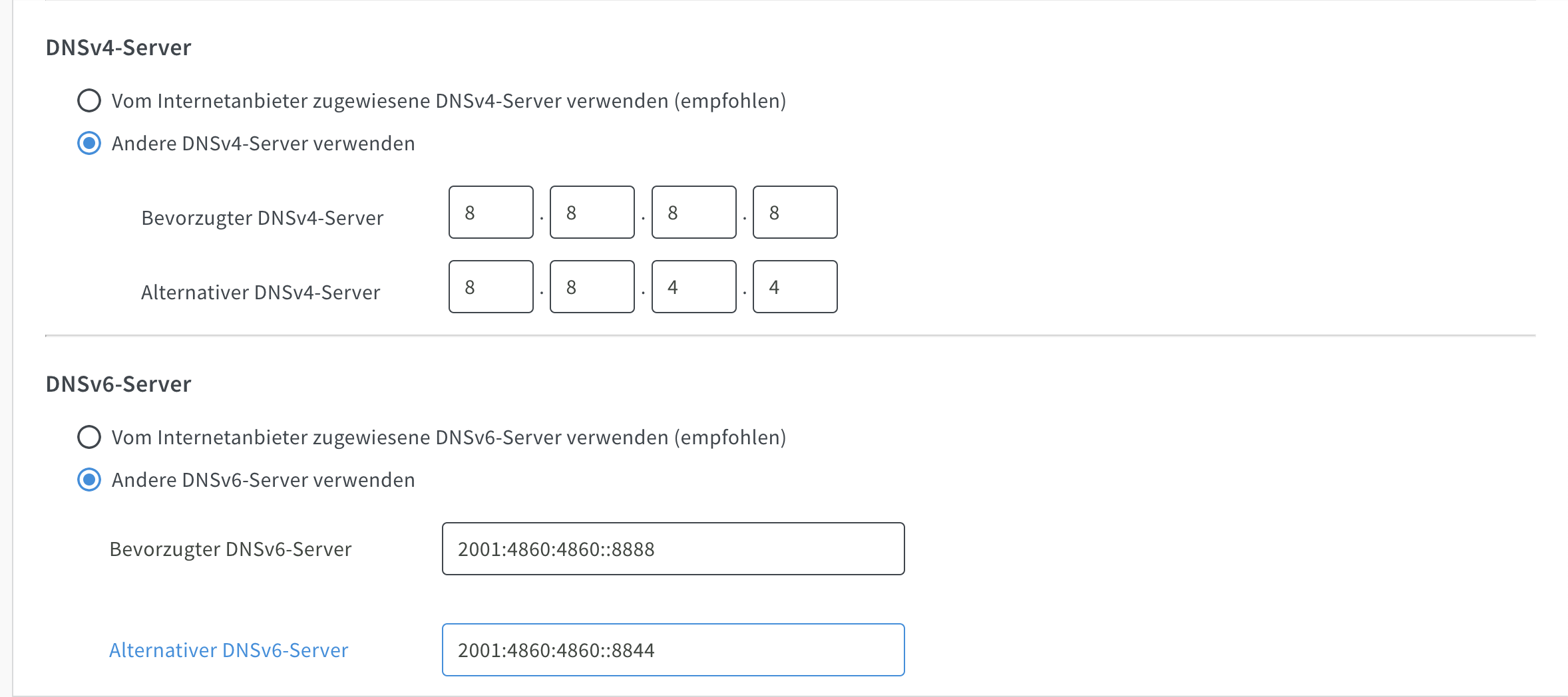

From what I see you have google as an upstream server for the pihole and your using conditional forwarding which is fine when the pihole is not the DHCP server.
Picture 3/5 shows WAN DNS settings ( for the routers upstream DNS ) and this is set the pihole and google ( IPV4 / IPV6 ). Its best not to use the pihole as the routers upstream DNS server. This should be changed to google / google or google / another DNS Server.
Picture 4 shows the LAN DNS Setting using pihole as the resolver, which is correct.

Reading through the Fritzbox guide it mentions that router will only use itself as the DNS resolver for the guest network.
If so I believe queries would look like they come from the router and not the oven. It could also cause a possible issue with resolving the host name if the router is sending that request to the pihole ( because WAN is set pihole / google ) and the pihole is using conditional forwarding and sending it to the router.

So i have changed the settings to:
correct? will the pihole still used as dns server with this settings?
(note: i have nothing changed else as the screenshot now)

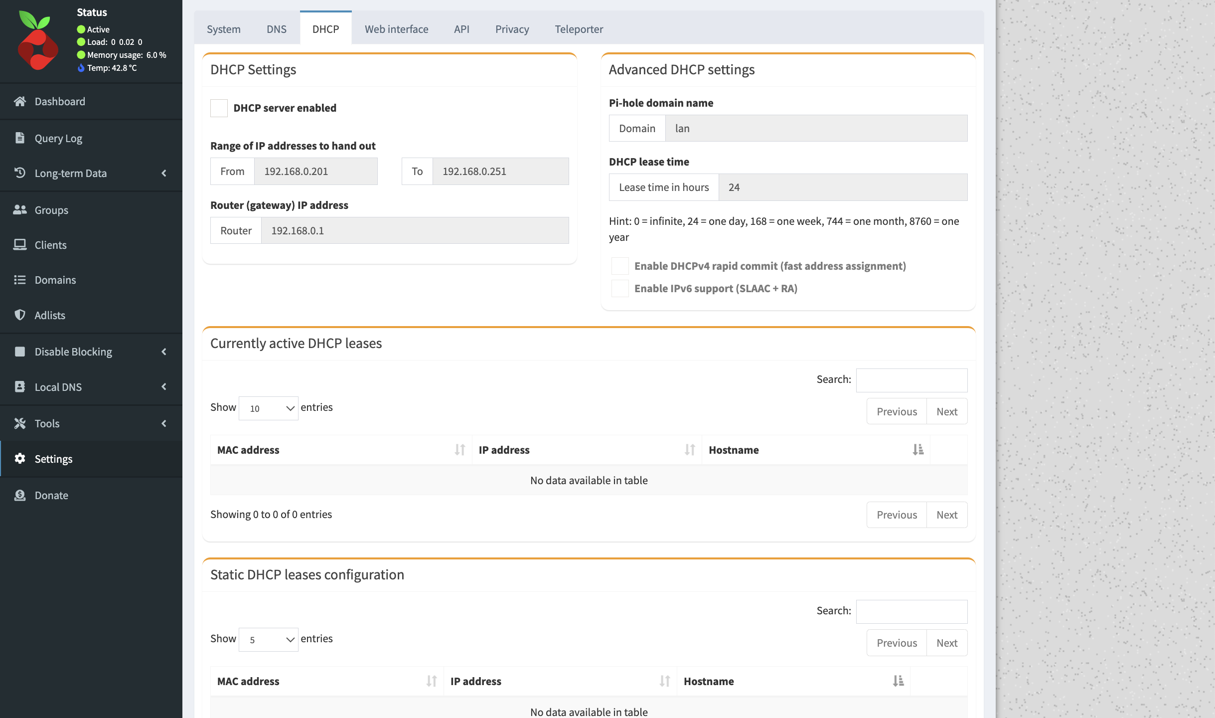

where/how can i double check, that the pihole is sure not the dhcp server?(only to be 100% safe)
which steps should i do next?
From the Piholes GUI go to Setting and chose the DHCP Tab. You would have to check the box to enable it so in your case it should be unchecked.
The pic you posted of the dishwasher / stove
Is that from the fritzboz / client info?
its unchecked, and i leave it unchecked - ok!
Yes its from the fritzbox overview, where i can see all network devices.

That pic indicates those clients can be edited. What options do you get? Any differences between the stove and dishwasher in those settings?
I did find a reddit post about the green icon / world icon. How accurate it is, I'm not sure.
https://www.reddit.com/r/fritzbox/comments/wywfbr/why_is_one_a_green_dot_and_the_other_one_a_map/?rdt=38883

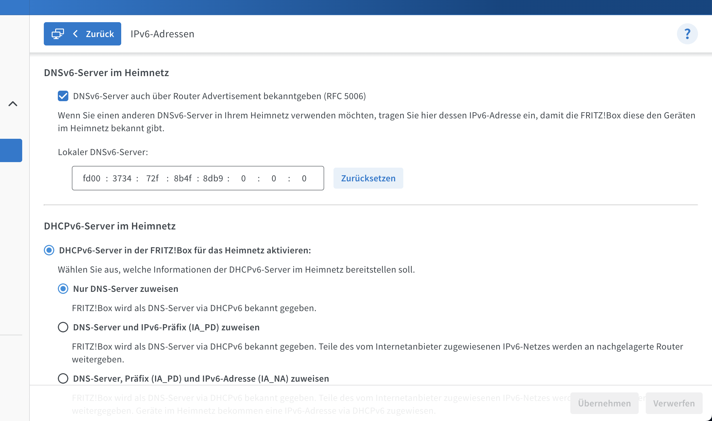

I checked the ipv6 settings in the fritzbox menu: is this ok?
the ipv4 setting is already posted here.

According to the Fritzbox guide this is ok but you want it be the correct IPV6 address. I'm not not sure what it is set to currently. Is that the routers IPV6 or the Piholes? Note: This woudn't cause the stove to not connect. It would possibly cause the stove to bypass the pihole for add blocking etc.
