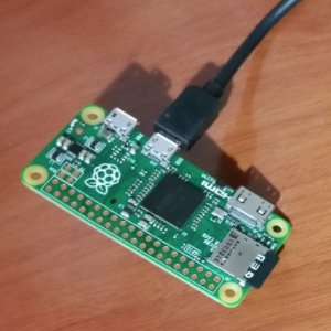

Eth0 not showing up for rpi zero w set up using chromecast ethernet adapter
I thought everything would work out of the box easily as this post suggests:
https://www.reddit.com/r/raspberry_pi/comments/3zha14/pizero_works_out_of_the_box_with_a_chromecast/
When using "pihole -r" I should get the option to select eth0, however, I only see wlan0 and usb0.
I am using a chromecast ethernet adapter plugged into the data/power port on the pi zero w and I had set up the pi zero w using ssh and connecting it via wlan0, I would now like to switch to a direct eth0 set up. I'm not sure if this post: https://www.reddit.com/r/pihole/comments/bdbbme/pi_zero_not_connecting_with_chromecast_psu_help/
is similar to what I'm encountering or not.
https://tricorder.pi-hole.net/n84s8xpg0c
You will likely need to use the usb0 interface, since that is what the ethernet adapter is physically plugged into on the Pi.
That is what I have it set up with right now, however, if I check in my isp connected devices list, the raspberry pi is shown as being connected in the Wireless 2.4GHz list. Additionally, running ifconfig shows as follows 000656|690x434

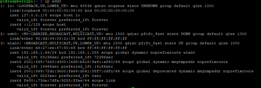

What is the output of the following from the Pi terminal:
ip addr
sudo grep -v '#\|^$' /etc/dhcpcd.conf
ip addr:
sudo grep -v '#|^$' /etc/dhcpcd.conf:
Could you copy/paste the text output instead of screenshots please ?
Enclose the output with the </> button before posting here.
That will make it much easier to read or copy paste particular code snippets for us.
As you might have noticed from the ip addr output, the usb0 interface shows the NO-CARRIER flag.
That would mean that the driver is detecting this interface not to be connected.
If you want that usb0 interface to be configured and used, you first have to fix that!

pi@raspberrypi:~ $ ip addr
    inet6 ::1/128 scope host
2: usb0: <NO-CARRIER,BROADCAST,MULTICAST,UP> mtu 1500 qdisc pfifo_fast state DOWN group default qlen 1000
    link/ether 92:3d:54:03:2c:38 brd ff:ff:ff:ff:ff:ff
3: wlan0: <BROADCAST,MULTICAST,UP,LOWER_UP> mtu 1500 qdisc pfifo_fast state UP group default qlen 1000
    link/ether b8:27:eb:87:50:69 brd ff:ff:ff:ff:ff:ff
    inet 192.168.1.86/24 brd 192.168.1.255 scope global dynamic noprefixroute wlan0
       valid_lft 76363sec preferred_lft 65563sec
    inet6 2001:569:72e5:d300:16d9:b618:9a41:a940/64 scope global dynamic mngtmpaddr noprefixroute
       valid_lft 10230sec preferred_lft 9930sec
    inet6 fe80::73da:7dfa:9255:ffae/64 scope link
^ ip addr after changing cables and ports to router
It still says NO-CARRIER.

lsusb
lsmod
EDIT And still, the device could be DOA.
Dont know if you have other means to test that Chromecast device ?
EDIT2: Ow most likely its below kernel module/driver:
pi@ph5:~ $ modinfo g_ether
description:    RNDIS/Ethernet Gadget
Interesting:
uname -r -v:
pi@raspberrypi:~ $ uname -r -v
5.4.72+ #1356 Thu Oct 22 13:56:00 BST 2020
lsusb:
pi@raspberrypi:~ $ lsusb
Bus 001 Device 001: ID 1d6b:0002 Linux Foundation 2.0 root hub
lsmod:
pi@raspberrypi:~ $ lsmod
Module                  Size  Used by
fuse                  114688  3
aes_arm                16384  1
aes_generic            40960  1 aes_arm
cmac                   16384  1
rfcomm                 49152  4
bnep                   20480  2
hci_uart               40960  1
btbcm                  16384  1 hci_uart
bluetooth             385024  29 hci_uart,bnep,btbcm,rfcomm
ecdh_generic           16384  2 bluetooth
ecc                    40960  1 ecdh_generic
libaes                 16384  3 bluetooth,aes_arm,aes_generic
8021q                  32768  0
garp                   16384  1 8021q
stp                    16384  1 garp
llc                    16384  2 garp,stp
brcmfmac              294912  0
brcmutil               20480  1 brcmfmac
sha256_generic         16384  0
libsha256              20480  1 sha256_generic
cfg80211              671744  1 brcmfmac
rfkill                 28672  6 bluetooth,cfg80211
raspberrypi_hwmon      16384  0
bcm2835_codec          36864  0
v4l2_mem2mem           32768  1 bcm2835_codec
bcm2835_v4l2           45056  0
bcm2835_isp            28672  0
snd_bcm2835            28672  2
bcm2835_mmal_vchiq     28672  3 bcm2835_isp,bcm2835_codec,bcm2835_v4l2
videobuf2_vmalloc      16384  1 bcm2835_v4l2
videobuf2_dma_contig    20480  2 bcm2835_isp,bcm2835_codec
videobuf2_memops       16384  2 videobuf2_dma_contig,videobuf2_vmalloc
videobuf2_v4l2         28672  4 bcm2835_isp,bcm2835_codec,bcm2835_v4l2,v4l2_mem2mem
snd_pcm                98304  1 snd_bcm2835
videobuf2_common       53248  5 bcm2835_isp,bcm2835_codec,bcm2835_v4l2,v4l2_mem2mem,videobuf2_v4l2
snd_timer              32768  1 snd_pcm
videodev              229376  6 bcm2835_isp,bcm2835_codec,videobuf2_common,bcm2835_v4l2,v4l2_mem2mem,videobuf2_v4l2
snd                    73728  7 snd_timer,snd_bcm2835,snd_pcm
vc_sm_cma              32768  2 bcm2835_isp,bcm2835_mmal_vchiq
mc                     45056  6 bcm2835_isp,bcm2835_codec,videobuf2_common,videodev,v4l2_mem2mem,videobuf2_v4l2
uio_pdrv_genirq        16384  0
uio                    20480  1 uio_pdrv_genirq
fixed                  16384  0
i2c_dev                16384  0
usb_f_ecm              16384  1
g_ether                16384  0
usb_f_rndis            28672  2 g_ether
u_ether                20480  3 usb_f_ecm,g_ether,usb_f_rndis
libcomposite           57344  3 usb_f_ecm,g_ether,usb_f_rndis
dwc2                  163840  0
udc_core               53248  5 usb_f_ecm,dwc2,u_ether,usb_f_rndis,libcomposite
ip_tables              28672  0
x_tables               32768  1 ip_tables
ipv6                  450560  29

It's not entirely clear what you are referring to by data/power port.
You want to make sure you don't stick the adapter in the port labeled PWR on your Zero board, but use the one labeled USB:

If you'd had plugged your Chromecast to the PWR port at least once, I suspect that Raspbian may not have detected the USB device correctly, and you are somehow stuck with that partial or incorrect detection.
To try to encourage device detection, did you try to start your Zero when powered by a dedicated PSU via the normal PWR port before plugging your Chromecast Ethernet PSU into USB without any external/additional power attached?
EDIT: Your lsusb output would imply you don't have any USB device attached. Is your Chromecast plugged into your Zero at the moment?
Does /etc/dhcpcd.conf still show eth0 or have you updated it to show usb0?
