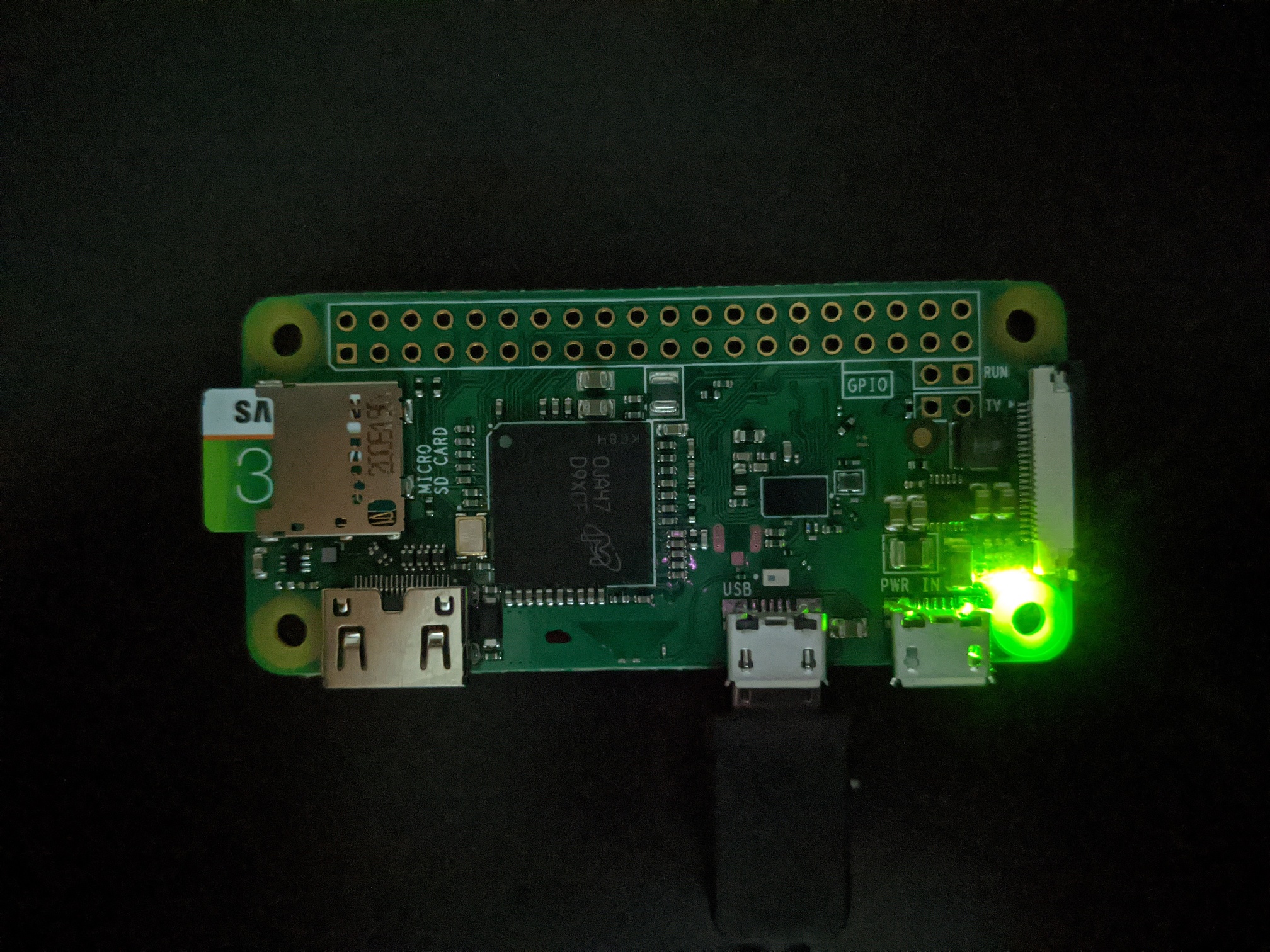

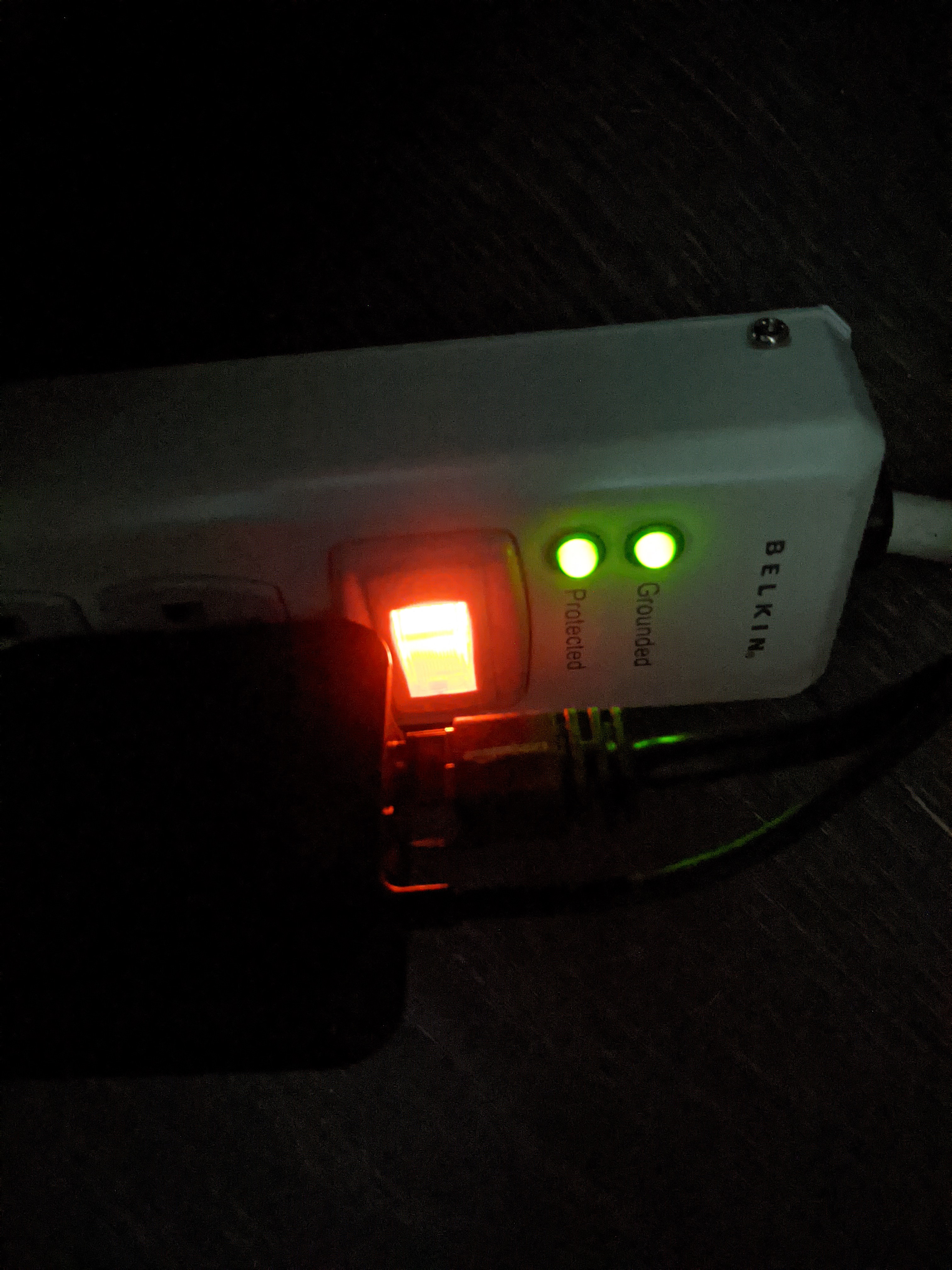

Your lsusb output would imply you don't have any USB device attached. Is your Chromecast plugged into your Zero at the moment?
Yes, the Chromecast Ethernet Adapter is plugged into the USB port as can be seen in these pictures:

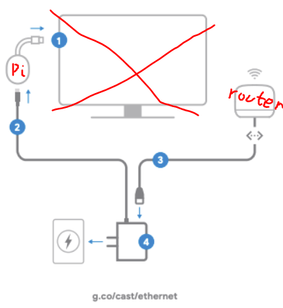

Adjusted drawing a bit:
I believe it might have something to do with the USB port being either in OTG host mode or device mode.
In host mode, you probably see the other Chromecast end as usb0.
In device mode it probably switches to eth0 reflecting the Pi-hole end and what seems to be requered for your case.
