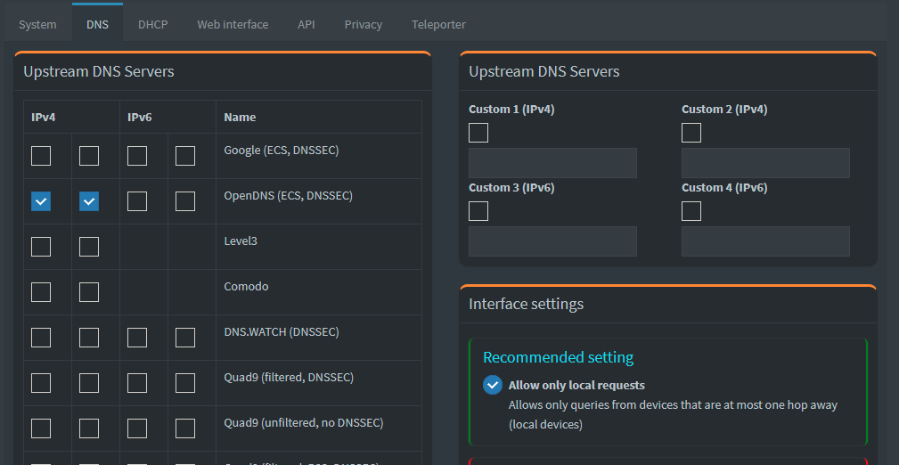

@chrislph not entirely sure what you mean when you say..."best to not let Pi-hole use itself for DNS resolution".. I have an Asus RT-AC86U router using wrtMerlin and I was told to set it up like this...

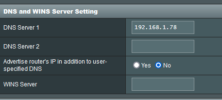

and to set the router's LAN setting like this...
192.168.1.78 is my Pihole IP. Is this not the correct way?
Your screenshots are all good.
  • Your router is managing DHCP and is telling clients on your network to use Pi-hole for DNS.
  • Clients on your network that use Pi-hole for DNS will benefit from the adlist blocking. Anything that Pi-hole does not block will be passed upstream to OpenDNS.

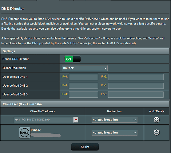

I can try that setting, but my router has a feature that forces all clients to use Pihole, (it intercepts port 53) so even If I manually tell Ubuntu or any device to use a custom DNS server, they won't be able to and will be forced to use whatever DNS server is set at the router level.
You're right, that will break the Ubuntu DNS setting and basically put you back to what you have now already. So best leave it as it is in Ubuntu.

Thanks for that. Good thing to try out. This is the feature I was referring to on my router, it can be turned off.
