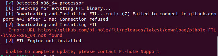

I ran sudo pihole -up and it starts the update, but then it stops and gives this error and I can't update it.
Error: URL https://github.com/pi-hole/ftl/releases/latest/download/pihole-FTL-linux-x86_64 not found

10
When using that code you provided, I get...

Connection refused
means that something, likely GitHub themselves, are blocking your access.
Our links are just fine, if they were broken then no one would be able to install Pi-hole and I know for a fact that isn't the case.
