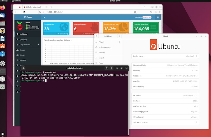

Can you describe how you did the Ubuntu update and Pi-hole each time, ie what order and how? I'm installing 22.04 LTS now to see if it happens here. Perhaps Ubuntu is trying to be too clever in something it does and messing around with Github access.

It's installed and working with Pi-hole also installed and working. I can reach Github no problem, and updates and pihole -up works. I'll snapshot the machine and try the updates in a couple of days when there are some, but I suspect it won't change anything.
chris@ubuntu-ph:~$ curl -IL https://github.com/pi-hole/ftl/releases/latest/download/pihole-FTL-linux-x86_64
HTTP/2 302
server: GitHub.com
date: Sat, 25 Feb 2023 22:24:28 GMT
