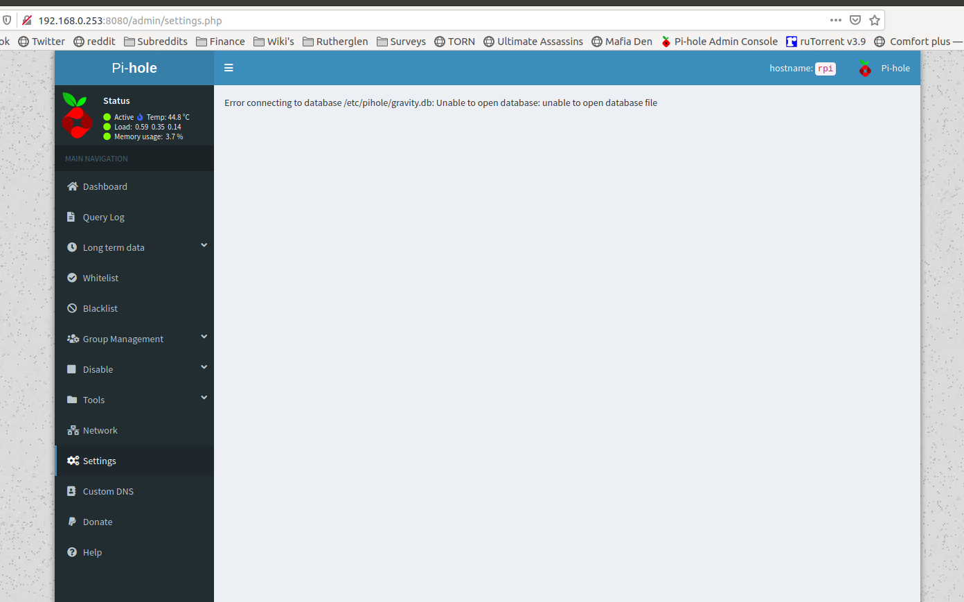

Getting error as shown in screenshot:
" Error connecting to database /etc/pihole/gravity.db: Unable to open database: unable to open database file"
However, blacklists do seem to be working, and dns resolution is as normal.
Also having trouble uploading log to tricorder
[image]

Your debug log shows a repeated error regarding the database:
-----head of pihole-FTL.log------
[2020-02-01 21:17:23.011 686] domain_in_list(configuration.ls.apple.com): Gravity database not available
What is the output of the following command from the Pi terminal:
ls -lha /etc/pihole/*.db

Taking another look at your debug log, you aren't fully on 5.0 beta. Your core version is on 4.3.x master. Run pihole checkout core release/v5.0 to get that portion of Pi-Hole on the 5.0 beta.
[i] Core: v4.3.2 (https://discourse.pi-hole.net/t/how-do-i-update-pi-hole/249)
[i] Branch: master
[i] Commit: v4.3.2-0-ge41c4b5
[i] Web: v4.3.2 (https://discourse.pi-hole.net/t/how-do-i-update-pi-hole/249)
[i] Branch: release/v5.0 (https://discourse.pi-hole.net/t/the-pihole-command-with-examples/738#checkout)
[i] Commit: v4.3.2-360-g88da85f
[✓] FTL: vDev-a90f14b (https://discourse.pi-hole.net/t/how-do-i-update-pi-hole/
The latest V5.0 should appear as follows:
[i] Commit: v4.3.2-391-ge0b3405
[i] Commit: v4.3.2-360-g88da85f5
[✓] FTL: vDev-a90f14b (https://discourse.pi-hole.net/t/how-do-i-update-pi-hole/249)
This solved it! Thanks for getting back so fast!
I don't know why it didn't work the first time...
