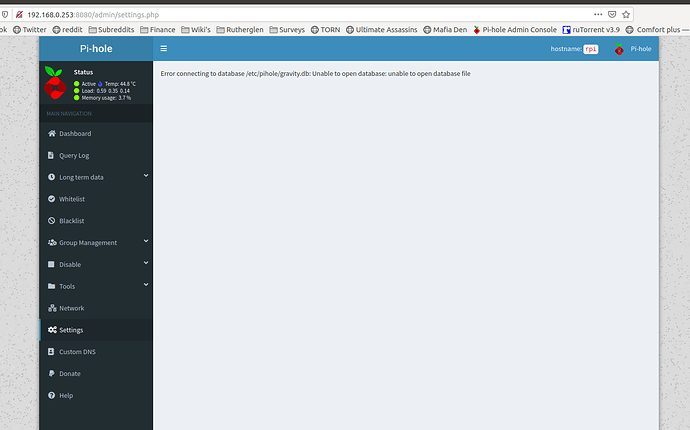

Error connecting to database /etc/pihole/gravity.db: Unable to open database: unable to open database file
Getting error as shown in screenshot:
" Error connecting to database /etc/pihole/gravity.db: Unable to open database: unable to open database file"
However, blacklists do seem to be working, and dns resolution is as normal.
Also having trouble uploading log to tricorder

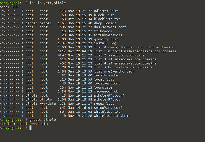

What does
ls -lh /etc/pihole
groups pihole
say?

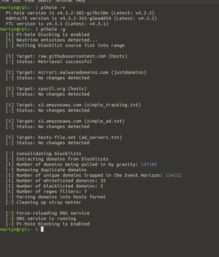

What does
pihole -v
say?
Please run
pihole -g
I just ran the instructions that were on the blog page announcing it.
Something seems to have gone wrong, your core code doesn't seem to have been upgraded.

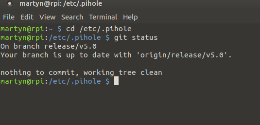

What is the output of
cd /etc/.pihole
git status

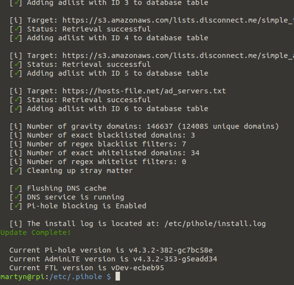

Okay, so this is unexpected. Do you still have the output that was generated during the upgrade? It not, please try
pihole -r
and chose Repair.

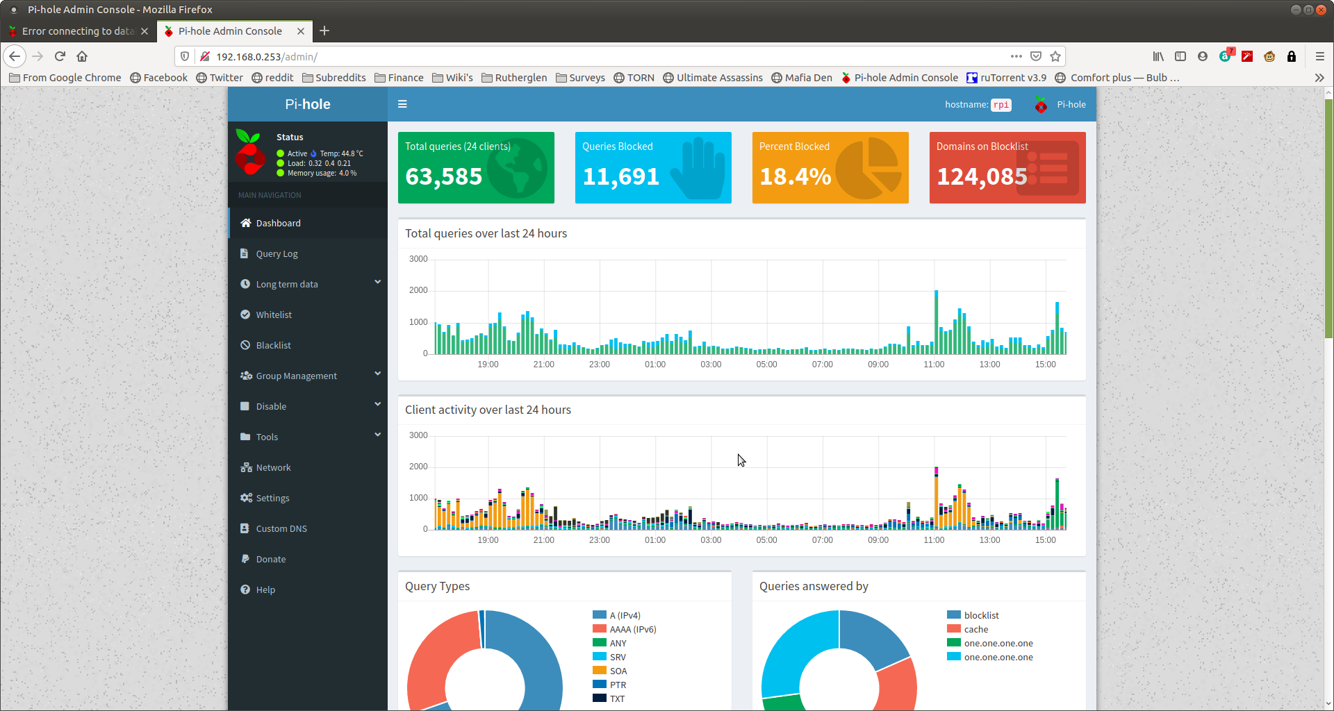

Its working now:
Thank You
Im guessing it for some reason failed to install the php7.3-intl first time round
