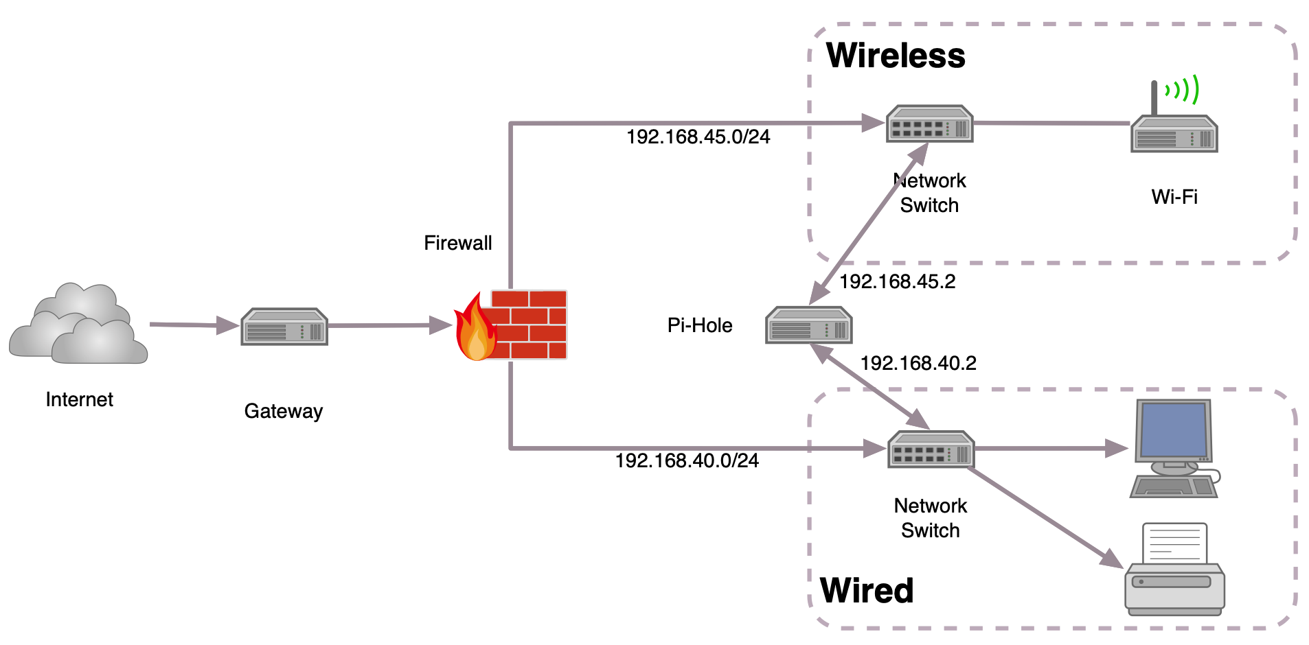

Dual subnet network - wired & wireless
Pi-Hole connected to two subnets AND both use Pi-Hole DNS.
Hello! I know I've seen this issue and solution posted but I cannot locate. I think I am searching for the wrong words. I thought I had read Pi-Hole could work on two networks after including a second Network. So I added a USB-to-Ethernet adapter and set it up as a static address. But no Pi-Hole DNS on the wireless network.
My Wired network is 192.168.40.1
My Wireless network is 192.168.45.1
DHCP is provided by a firewall. DNS from Pi-Hole.
The Pi-Hole is currently connected and working perfectly on the wired network. Pi-Hole is 192.168.40.2 and is using eth0.
I went to the menu Settings > DNS tab > Interface listening behavior and enabled Listen on all interfaces.

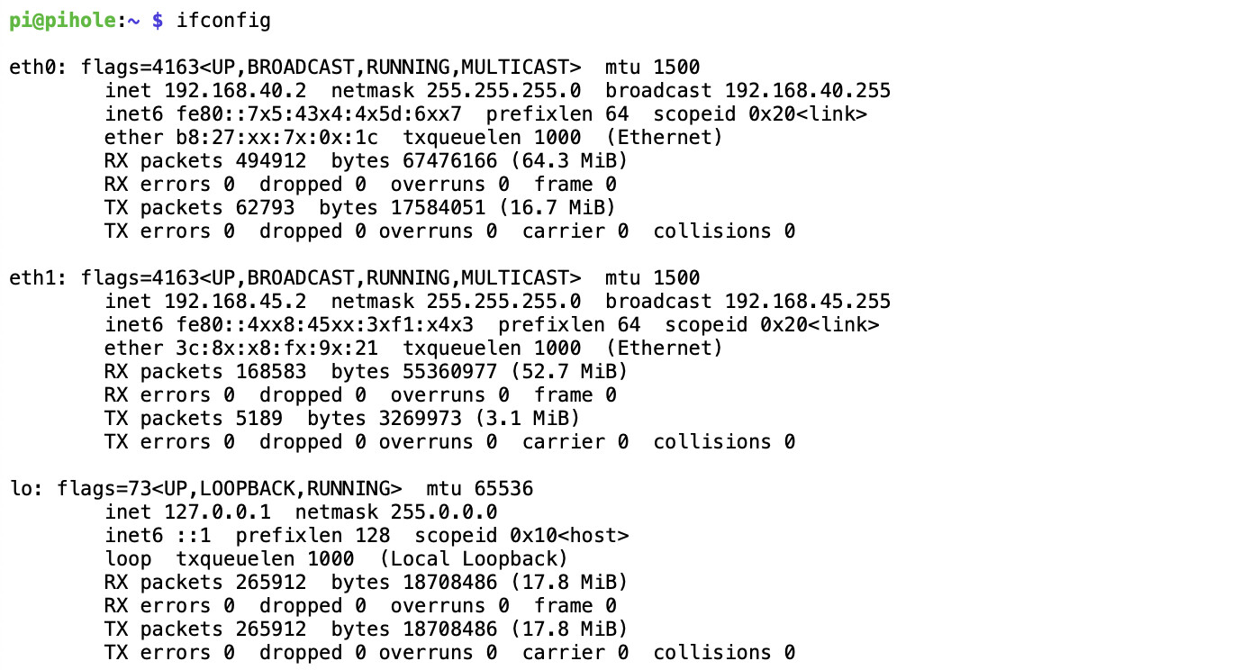

I added a USB-to-Ethernet adapter to the Pi-Hole and set it up as a static address. It connect to the wireless network as a wired device at 192.168.45.2 via eth1.
My test machine is a laptop connected to the wireless network and with the DNS set to 192.168.45.2. I can connect to the Pi-Hole web interface via the Wireless network. No issues there.
But nothing good happens. And I cannot find the post I thought I saw and I was not able to find what I needed in the docs.
Info: Pi-hole v5.3.1 / Web Interface v5.5 / FTL v5.8
So I am guessing I am missing a a few more steps... Is the above possible? Or should I build up a second Pi-Hole for the wireless?

I'm not sure what this means. There is network traffic on this network. And I can ping the eth1 interface via 192.168.45.2.
My setup is not a VLAN. Two network ports from the firewall. Both on separate subnets.
No. Right now I am only testing with my laptop and the DNS is set to 192.168.45.2. No other DNS servers. The DNS setting is manually configured. So not taken from the DHCP server at this time.
Yes. And I can access the Pi-Hole webgui at 192.168.45.2.
I am guessing this is the problem. Or part of the problem.

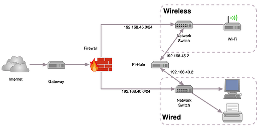

So I wanted to document (yes here!) what you had told me and what I had done. But when I deleted my /etc/dnsmasq.d/02-my_pihole.conf file and restated via sudo service pihole-FTL restart nothing changed. I also tried rebooting my Pi-Hole box. I could NOT get my changes to stop working. This doesn't make sense!
I tried clearing the browser cache - no joy. I cleared the local DNS cache on my Mac via sudo dscacheutil -flushcache; sudo killall -HUP mDNSResponder - also no joy.
Is there something within Pi-Hole that needs to be cleared or changed to put things back to the beginning?
