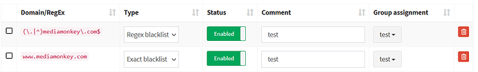

The issue I am facing:
I am trying to configure pihole to block a domain. pihole will accept the domain as entered but when I open a firefox private browser and navigate to that domain the web page loads without issue. I have tried multiple domains and get the same result. I read that a private browser is best to test since the domain should not be cached by the browser and will immediately be updated. I tried flushing the dns record from a command line (ipconfig /flushdns) but it did not change anything so I believe this is a pihole settings issue.
If I add the domain as an exact blacklist it does show up in the list but it still allows the browser to load the page.

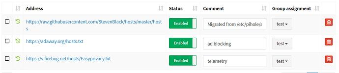

I am testing pihole with a near stock installation. The only thing I changed was to add 2 more block lists and a single arbitrary domain. My ultimate goal is to run pihole on my Synology NAS through a docker container but I am testing a more standard setup until I understand how things need to be configured.

Added 2 add lists from firebog.net repository

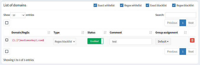

The machine I have been testing on is a Win10 machine. I just tried changing the settings in pihole so this one machine would be on a group named "test" and made default unfiltered so I could set the router to use the pihole. I now have the router set such that the DNS should go to the pihole machine.
