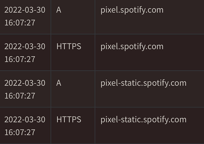

Anything else missing? Searching the query log when attempting to play content unfortunately does not reveal blocked domains related to Spotify. Only I could find is this (definitely tracking related):
as well as

  • i closely monitored the hostnames in query log when trying to play/download Spotify content (which has not yet been cached). only blocked ones are
2022-04-08 23:48:37 	A		firebaselogging-pa.googleapis.com	iPhone	Blocked (gravity)	IP (0.0ms)
2022-04-08 23:48:37 	HTTPS	firebaselogging-pa.googleapis.com	iPhone	Blocked (gravity)	NODATA (0.1ms)
