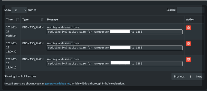

I updated recently and looks like I am seeing something similar. Not sure exactly what this means though.
Version:
Docker Tag 2021.12
Pi-hole [v5.7]
FTL [v5.12]
Web Interface [v5.9]
Image of the warnings I am seeing.
I run a pfsense router which is the IP I have masked out, if that info is helpful at all.
@LIGISTX as I said above, this comes either from a misconfiguration of a component in your network (most likely the DNS server, but it can also be a router) or a bad default. See DNSMASQ_WARN reducing DNS packet size - #9 by DL6ER for a the solution. Note that setting a lower maximum packet size is not a workaround but a proper solution in this case.
