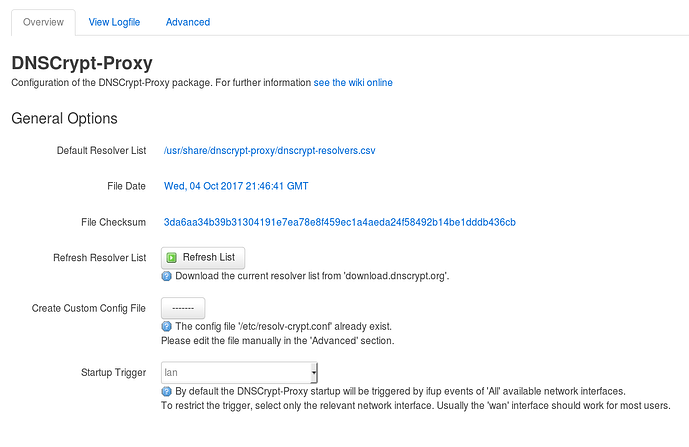

Help, I have a router flashed with OpenWrt and DNSCrypt, does anyone know how to configure Pi Hole correctly?

I think it does not explain to me because of my bad English, I have a small router that runs OpenWrt with DNSCrypt, and I have acquired a small pi rasperry in which I have installed Pi-Hole v4, I have to make a special configuration so that it works correctly. router (OpenWrt with DNSCrypt) and my Rasperry (Pi Hole}.
