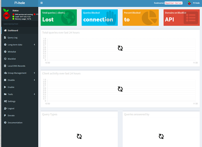

Hello,
I did a clean (fresh) install in my raspberry pi 4B with the Latest Raspbian (Buster) and Repetier Server image for PI. I have Downloaded the latest image from this site: Raspberry Pi Image - Repetier-Server and use PI Imager. After that i did the pihole installation but the dns service is not running as you can see on the attached image.
Despite being an image (OS) on their website (repetier-server), the image is running the latest raspbian version based on debian buster. I send an image attached with the operating system, using the command "cat /etc/os-release", so you can check.
Can you help me with that? Thanks in advance.
