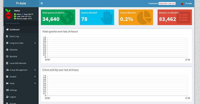

As you can see on the atached foto. It works and is installed on the same system, but gives me other problems, so I wanted to do a clean installation

Deducting from this line and the stats of your screenshot I would guess: yes.
Problem solved?
