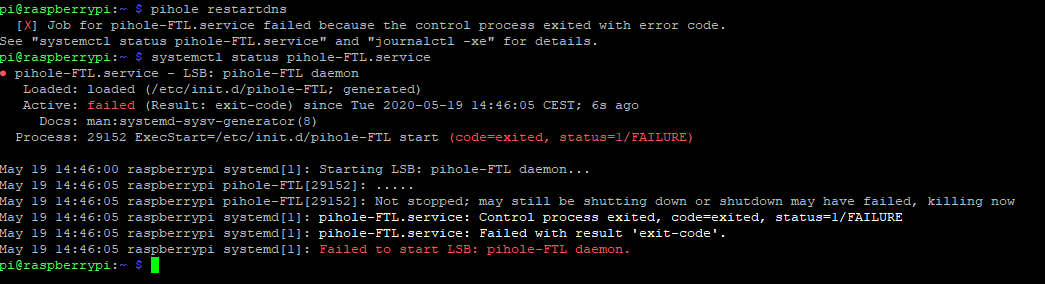

After 2-3 hours of normal operation I get the message from padd.sh that DNS is off and the webinterface is not responding anymore or very slow. Logging in via SSH always works. When I try to restart the DNS service I get the message
Job for pihole-FTL.service failed because the control process exited with error code.
When I check systemctl status I get this message:
Only a hard reboot of my pi "fixes" this problem. But always reappears after 2-3 hours.

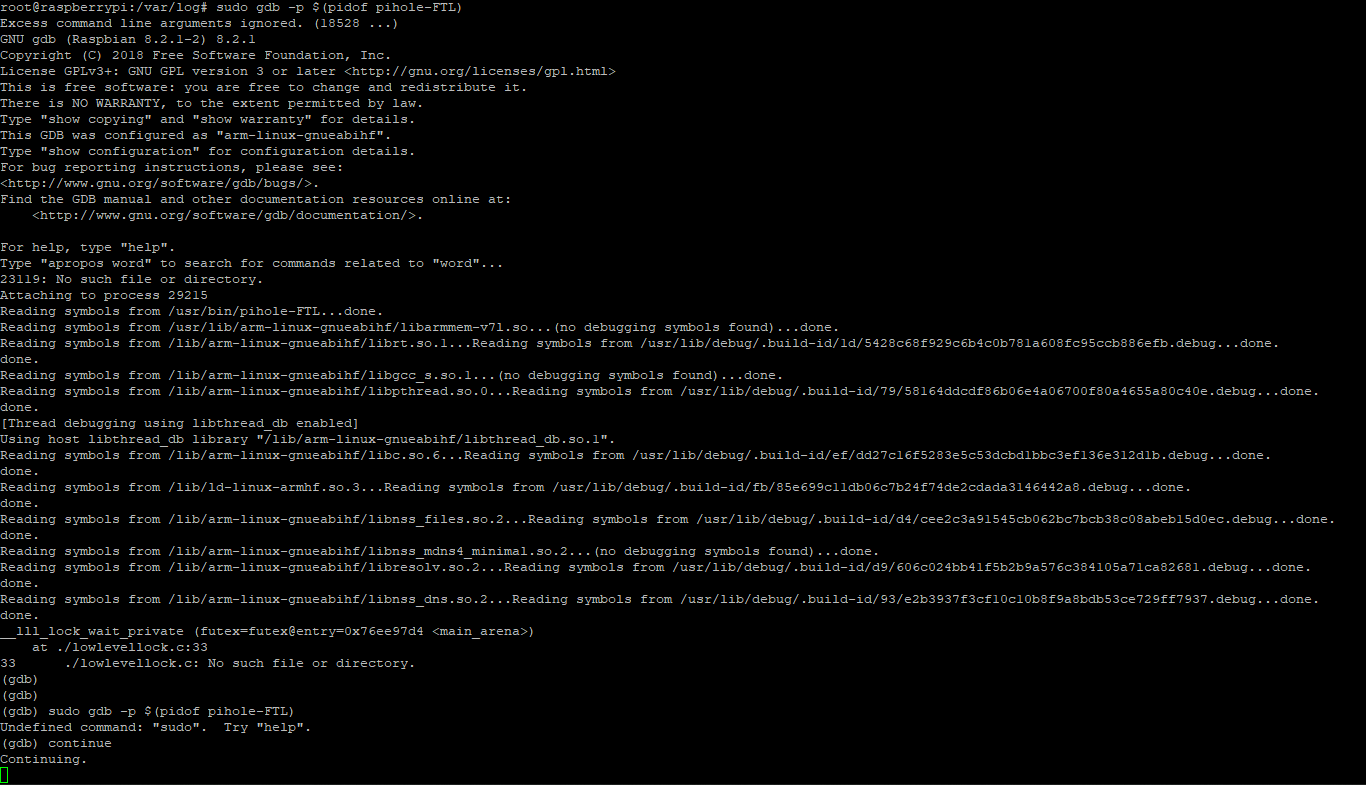

If you want to be super awesome you could attach a debugger to pihole-FTL as described here:
This would give additional information if it crashed again.
ok will do that later. Needa head to the next meeting. Thx alot for your help. Really appreciate it!
I believe it is now "screening". As I said I am not too familiar with that kinda stuff. Does this look OK?
I'm not familiar with the debugger but at first sight is looks good. I'll think we just leave it now as it is and wait for the devs :slight_smile:
You shouldn't have run the sudo ... line in the debugger ((gdb) prompt), however it should not have caused issues. We will find out when the crash happens and we either get or don't get meaningful data. Until then, we are eagerly expecting what will happen.
yea I noticed that too after entering the line :stuck_out_tongue:
so meanwhile pihole crashed again but I don't see any output in the terminal.
As far as I understood the documentation I should see an output in the terminal, right?

EDIT: When I "quit" it says "Debugging Session Active". Is the data being dumped to a file?
Hmm, so something went wrong. It may be that you had several forks of pihole-FTL running when attaching the debugger and, by chance, we picket the wrong one.
Next time, instead of
sudo gdb -p $(pidof pihole-FTL)
please use
sudo gdb -p 13813
where this 13813 is the number you get from the command
grep "PID of FTL process" /var/log/pihole-FTL.log | tail -n1 | sed "s/.*: //"
Sorry for that, however, it is not always as straightforward to debug a multi-parallel application (using threads and process-forks at the same time).
No, you terminated the debugging session by quitting.
