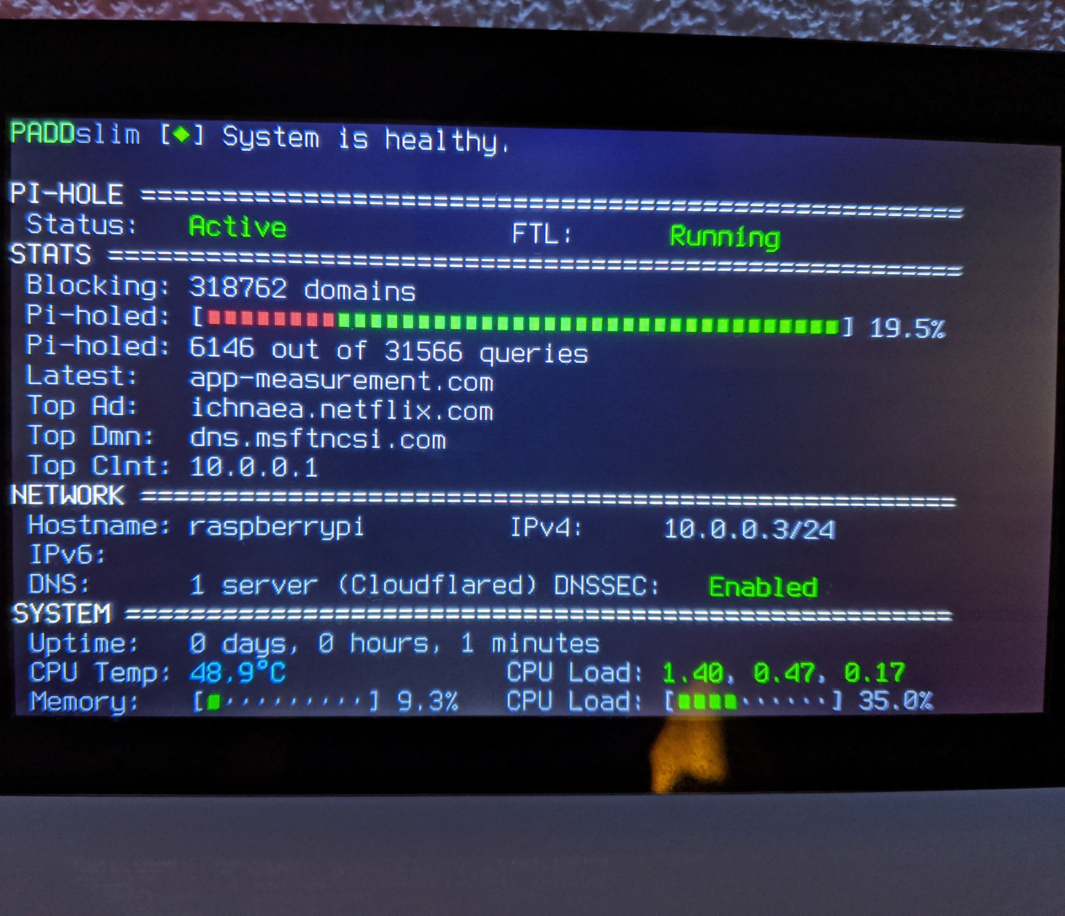

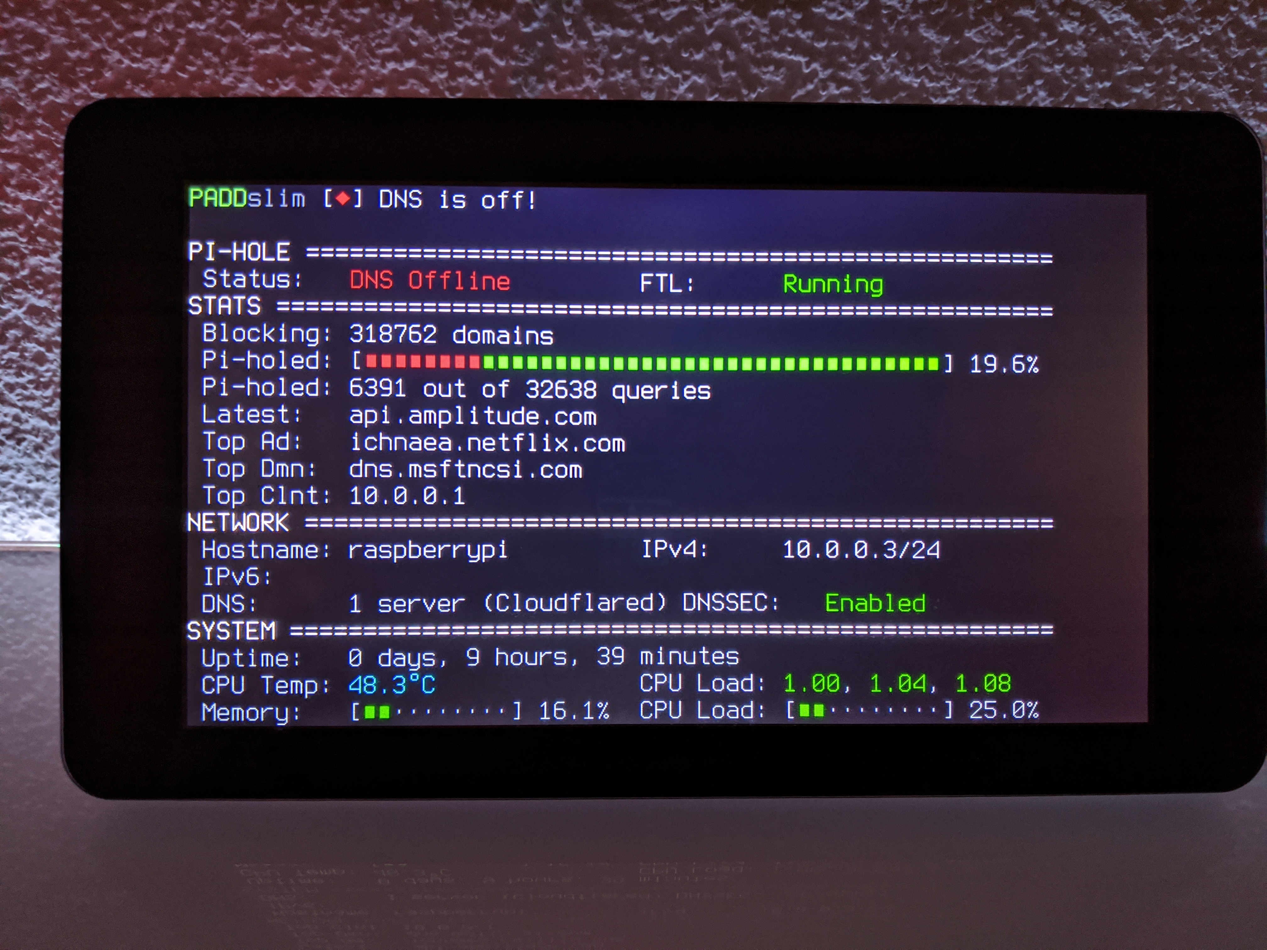

Worked fine for about 9 hours:
After reboot everything looks fine again:

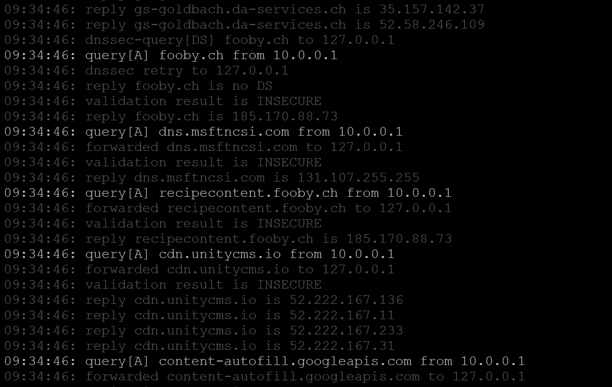

Sidenotes: As I already mentioned above, when this issue occurs the pi webadmin interface is super slow. Also I just checked pihole -t and although it says "DNS Offline", resolution still seems to work (at least partially):
It is actually very strange that I'm not encountering this crash, even though I try hard. Could you maybe again share all the details you think are relevant to the issue? Maybe I cannot reproduce because this is triggered by some special combination of some queries in a specific order. Like with these Microsoft Office crashes.
This does absolutely not look like a crash. FTL is still running absolutely fine and smooth when this is the only thing you see. Very obscure.
