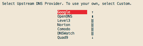

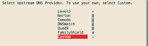

I've attached screenshots that include all the DNS provider options I had access to:
Unless I'm mistaken, it looks like Cloudflare isn't there?
Correct. They are not available in this version of the installer (they have been added to the Beta one).
