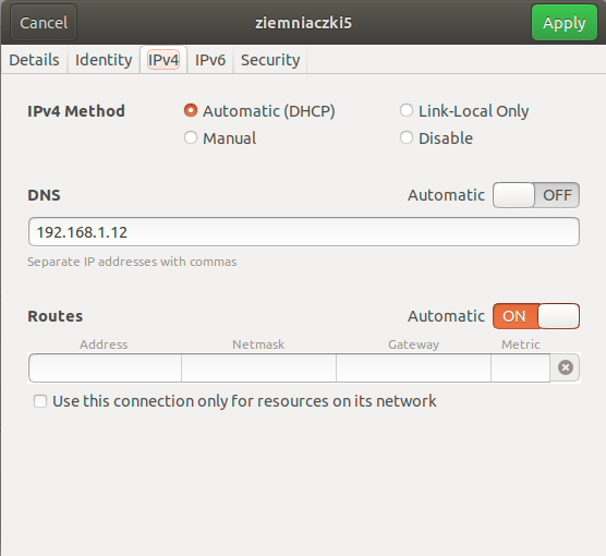

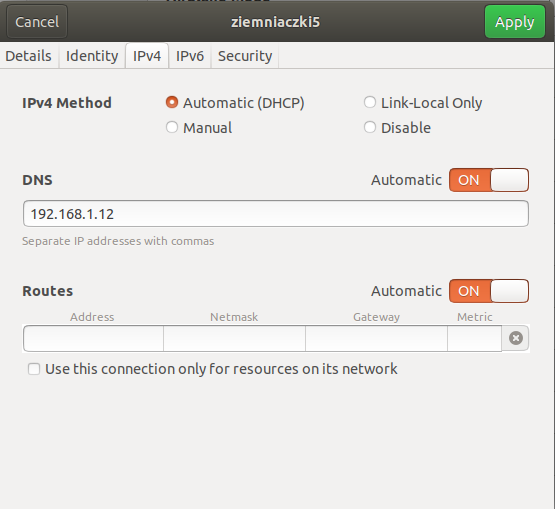

So as mentioned above pihole works like a charm over vpn, but it stops working when I try to set it as dns on both my laptop with ubuntu 18.04 and phone with miui 11.
In this configuration I have access to the internet, but nothing appears in the query log. I can't access pi.hole/admin. 192.168.1.12/admin works.
In this configuration I have no access to internet, I can't access pi.hole/admin, 192.168.1.12/admin works.
