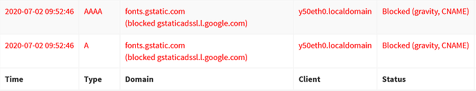

in the pihole query log, I see (deep CNAME inspection)
however, in the pihole log, I cannot find any reference to gstaticadssl.l.google.com, only to fonts.gstatic.com

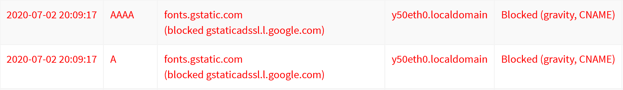

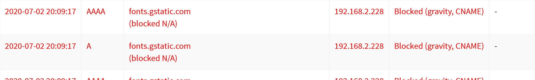

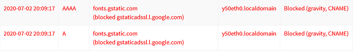

An additional reason for this request:
When pihole-FTL is running, a blocked entry (deep CNAME inspection) looks like this (actually blocked domain name is available)
If you than stop/start pihole-FTL (for whatever reason) the information is no longer available, the entry looks like this:
Being able to retrieve the reason for blocking from the log makes life easier...
