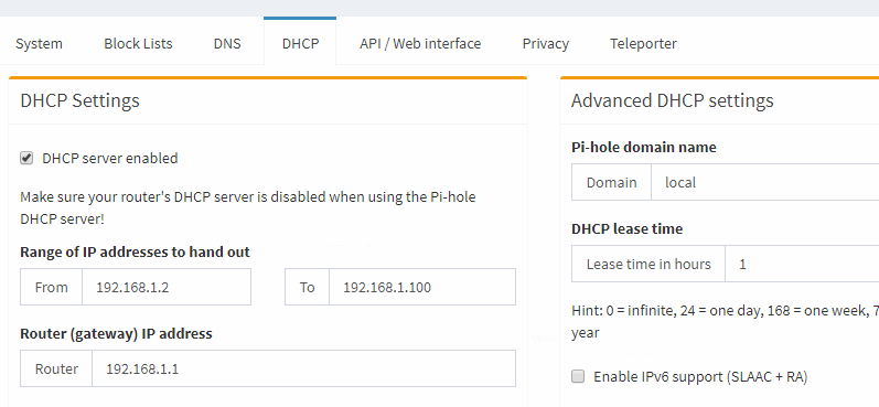

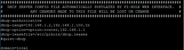

DHCP is enabled form the /admin/ interface. If DHCP is enabled and it's working, the interface should show DHCP as being enabled.
Same parameters should be in /etc/dnsmasq.d/02-pihole-dhcp.conf.
(replace IPs with whatever your range is).
